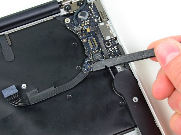

  6. MacBook Air 11" Mid 2012 Upper Case Replacement, I/O Board Cable: crwdns2935265:06crwdnd2935265:01crwdnd2935265:01crwdne2935265:0
    • Use the flat end of a spudger to pry the I/O board cable up from its socket on the I/O board.
  7. MacBook Air 11" Mid 2012 Upper Case Replacement: crwdns2935265:07crwdnd2935265:01crwdnd2935265:01crwdne2935265:0
    • Peel the I/O board cable up from the adhesive securing it to the fan.
  8. MacBook Air 11" Mid 2012 Upper Case Replacement: crwdns2935265:08crwdnd2935265:01crwdnd2935265:02crwdne2935265:0 MacBook Air 11" Mid 2012 Upper Case Replacement: crwdns2935265:08crwdnd2935265:02crwdnd2935265:02crwdne2935265:0
    • Use the flat end of a spudger to lift the I/O board connector up and out of its socket on the logic board
    • Be sure to lift straight up on the connector as you disconnect it from its socket. The socket is very deep on the logic board and prying it from side to side may damage the logic board
    • Remove the I/O board cable.

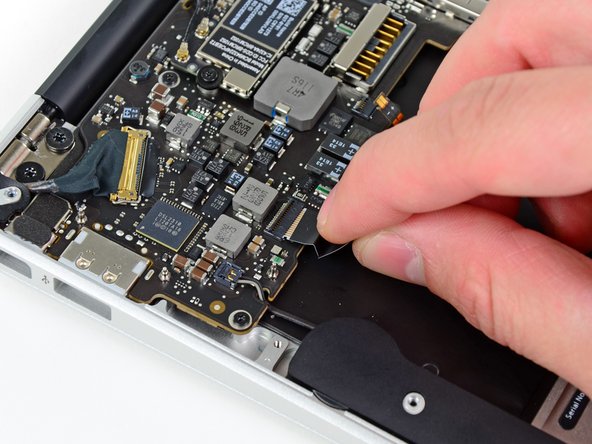

  14. MacBook Air 11" Mid 2012 Upper Case Replacement, Logic Board: crwdns2935265:014crwdnd2935265:01crwdnd2935265:02crwdne2935265:0 MacBook Air 11" Mid 2012 Upper Case Replacement, Logic Board: crwdns2935265:014crwdnd2935265:02crwdnd2935265:02crwdne2935265:0
    • Use the flat end of a spudger to free the adhesive loop securing the I/O board power cable to the upper case.
    • Disconnect the I/O board by pulling the power cable away from its socket on the logic board.
    • Pull the cable parallel to the face of the logic board toward the front edge of the Air.
  15. MacBook Air 11" Mid 2012 Upper Case Replacement: crwdns2935265:015crwdnd2935265:01crwdnd2935265:02crwdne2935265:0 MacBook Air 11" Mid 2012 Upper Case Replacement: crwdns2935265:015crwdnd2935265:02crwdnd2935265:02crwdne2935265:0
    • Use the tip of a spudger to flip up the retaining flap on the keyboard backlight ribbon cable ZIF socket.
    • Pull the keyboard backlight ribbon cable out of its socket.

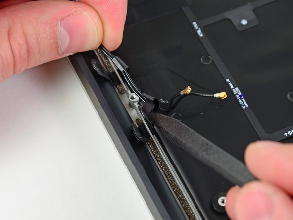

    • Peel up the six cable loops securing the antenna cables to the upper case.
    • Gently pull the cable loops slightly out of the channel cut into the upper case one at a time.
    • Use your spudger to open up the plastic loops as you de-route the antenna cables through them.
    • Repeat this for all of the retaining loops.

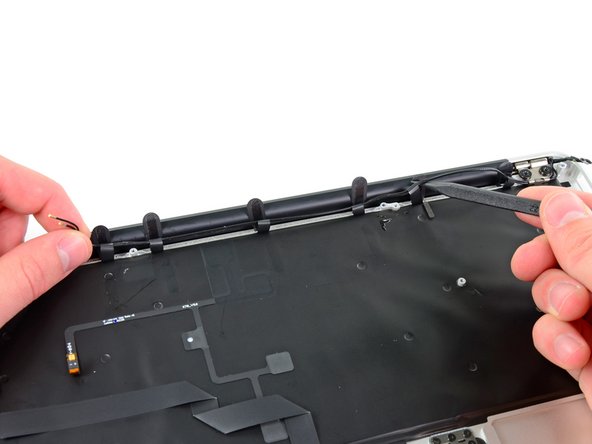

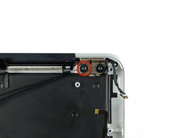

  32. MacBook Air 11" Mid 2012 Upper Case Replacement: crwdns2935265:032crwdnd2935265:01crwdnd2935265:02crwdne2935265:0 MacBook Air 11" Mid 2012 Upper Case Replacement: crwdns2935265:032crwdnd2935265:02crwdnd2935265:02crwdne2935265:0
    • Remove the inner 4.9 mm T8 Torx screw securing each display hinge to the upper case (two screws total).
  33. MacBook Air 11" Mid 2012 Upper Case Replacement: crwdns2935265:033crwdnd2935265:01crwdnd2935265:01crwdne2935265:0
    • Open the display until it is perpendicular to the upper case and place it on a table as shown.

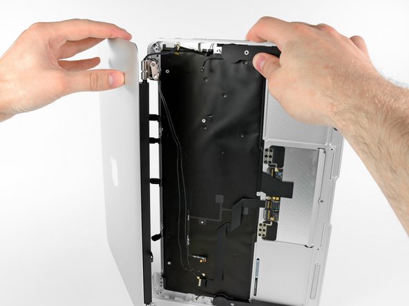

  35. MacBook Air 11" Mid 2012 Upper Case Replacement: crwdns2935265:035crwdnd2935265:01crwdnd2935265:02crwdne2935265:0 MacBook Air 11" Mid 2012 Upper Case Replacement: crwdns2935265:035crwdnd2935265:02crwdnd2935265:02crwdne2935265:0
    • Push the upper case slightly toward the display assembly, then rotate it away from the front of the display assembly.
    • Once the two display hinges have cleared the upper case, remove the display and set it aside.
