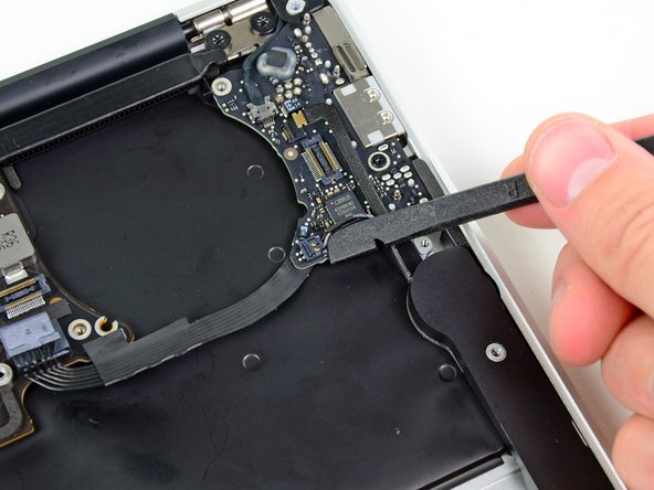

  6. MacBook Air 11" Mid 2012 I/O Board Replacement, I/O Board Cable: crwdns2935265:06crwdnd2935265:01crwdnd2935265:01crwdne2935265:0
    • Use the flat end of a spudger to pry the I/O board cable up from its socket on the I/O board.

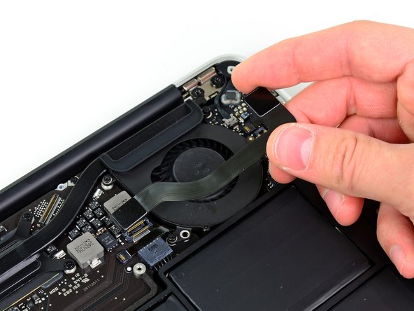

  7. MacBook Air 11" Mid 2012 I/O Board Replacement: crwdns2935265:07crwdnd2935265:01crwdnd2935265:01crwdne2935265:0
    • Peel the I/O board cable up from the adhesive securing it to the fan.

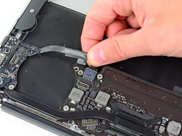

    • Use the flat end of a spudger to lift the I/O board connector up and out of its socket on the logic board
    • Be sure to lift straight up on the connector as you disconnect it from its socket. The socket is very deep on the logic board and prying it from side to side may damage the logic board
    • Remove the I/O board cable.

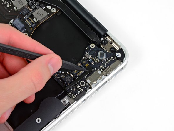

    • Use the tip of a spudger to carefully flip up the retaining flap on the microphone cable ZIF socket.
    • Be sure you are prying up on the retaining flap, not the socket itself.
    • Pull the microphone ribbon cable straight out of its socket.
