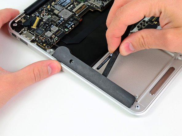

  6. MacBook Air 11" Mid 2011 Right Speaker Replacement, Right Speaker: crwdns2935265:06crwdnd2935265:01crwdnd2935265:01crwdne2935265:0
    • Use the tip of a spudger to de-route the right speaker cable from the channel cut into the logic board.
  7. MacBook Air 11" Mid 2011 Right Speaker Replacement: crwdns2935265:07crwdnd2935265:01crwdnd2935265:01crwdne2935265:0
    • Use the flat end of a spudger to pry the right speaker cable connector up and out of its socket on the logic board.
    • Pry upward from beneath the wires.
  8. MacBook Air 11" Mid 2011 Right Speaker Replacement: crwdns2935265:08crwdnd2935265:01crwdnd2935265:02crwdne2935265:0 MacBook Air 11" Mid 2011 Right Speaker Replacement: crwdns2935265:08crwdnd2935265:02crwdnd2935265:02crwdne2935265:0
    • Use the flat end of a spudger to pry the right speaker off the adhesive securing it to the upper case.
    • Only pry up on the speaker from the areas of bare aluminum on the upper case. Prying up from the keyboard area may damage the keyboard and the speaker itself.
  9. MacBook Air 11" Mid 2011 Right Speaker Replacement: crwdns2935265:09crwdnd2935265:01crwdnd2935265:01crwdne2935265:0
    • Remove the right speaker from the upper case.
