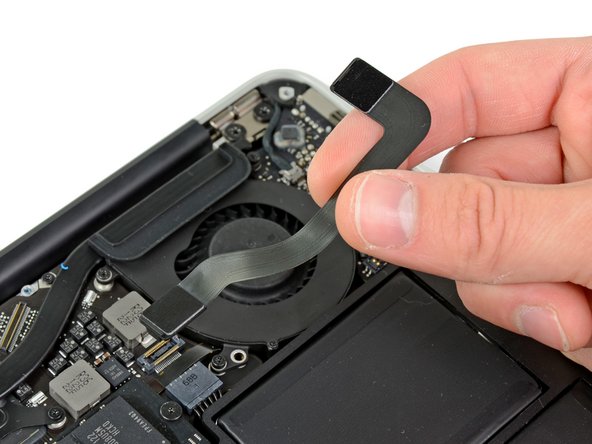

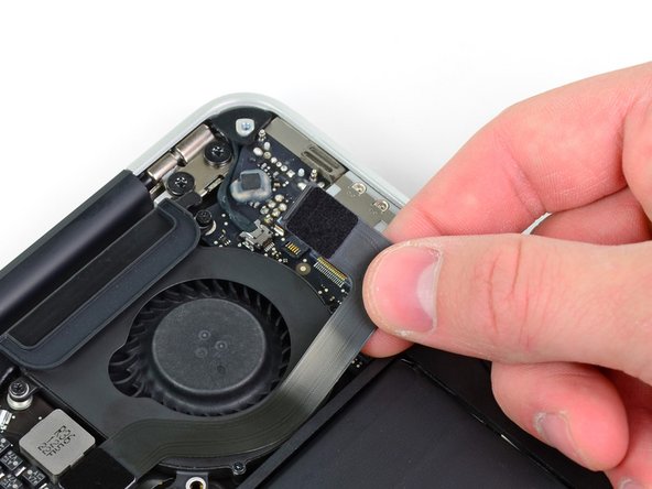

  4. MacBook Air 11" Mid 2011 I/O Board Cable Replacement, I/O Board Cable: crwdns2935265:04crwdnd2935265:01crwdnd2935265:02crwdne2935265:0 MacBook Air 11" Mid 2011 I/O Board Cable Replacement, I/O Board Cable: crwdns2935265:04crwdnd2935265:02crwdnd2935265:02crwdne2935265:0
    • Use the flat end of a spudger to pry the I/O board cable connector upward out of its socket on the I/O board.
  5. MacBook Air 11" Mid 2011 I/O Board Cable Replacement: crwdns2935265:05crwdnd2935265:01crwdnd2935265:02crwdne2935265:0 MacBook Air 11" Mid 2011 I/O Board Cable Replacement: crwdns2935265:05crwdnd2935265:02crwdnd2935265:02crwdne2935265:0
    • The following connector has an especially deep socket. Use care when disconnecting it.
    • While gently pulling the I/O board cable upward near its connection to the logic board, use the tip of a spudger to pry upward on alternating sides of the connector to help "walk" it out of its socket.
    • Remove the I/O board cable.
