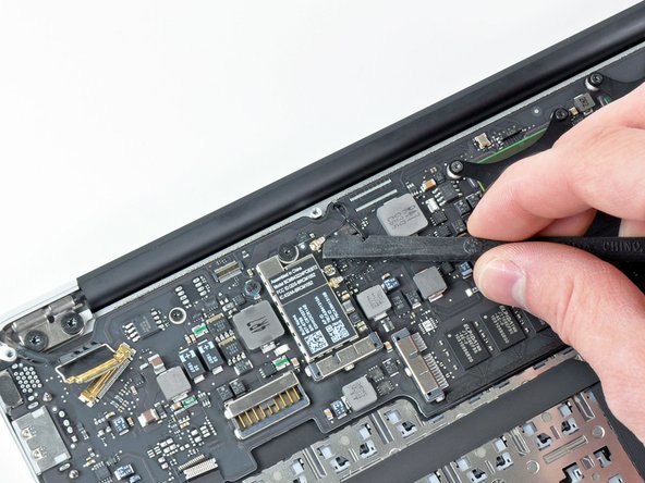

    7. MacBook Air 11" Late 2010 Upper Case Replacement: crwdns2935265:020crwdnd2935265:01crwdnd2935265:02crwdne2935265:0 MacBook Air 11" Late 2010 Upper Case Replacement: crwdns2935265:020crwdnd2935265:02crwdnd2935265:02crwdne2935265:0
      • Use the flat end of a spudger to pry both antenna cable connectors up and off their sockets on the AirPort/Bluetooth card.
    8. MacBook Air 11" Late 2010 Upper Case Replacement: crwdns2935265:021crwdnd2935265:01crwdnd2935265:01crwdne2935265:0
      • Gently de-route the antenna cables from the slot cut into the logic board.
    9. MacBook Air 11" Late 2010 Upper Case Replacement: crwdns2935265:022crwdnd2935265:01crwdnd2935265:01crwdne2935265:0
      • Remove the three 3.6 mm T5 Torx screws securing the logic board to the upper case.
    10. MacBook Air 11" Late 2010 Upper Case Replacement: crwdns2935265:023crwdnd2935265:01crwdnd2935265:01crwdne2935265:0
      • Gently lift the logic board assembly out of the upper case, minding the fragile heat sink and any cables that may get caught.

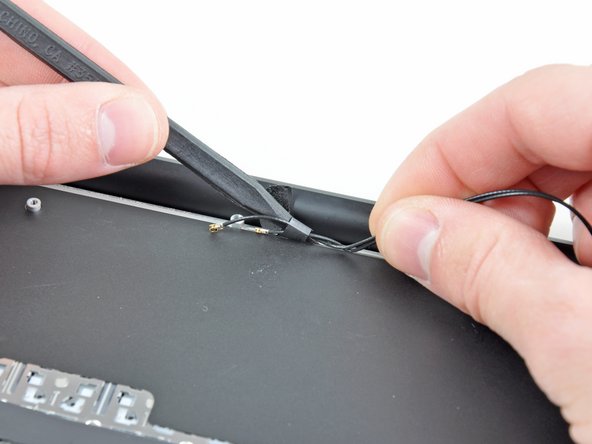

    3. MacBook Air 11" Late 2010 Upper Case Replacement: crwdns2935265:026crwdnd2935265:01crwdnd2935265:03crwdne2935265:0 MacBook Air 11" Late 2010 Upper Case Replacement: crwdns2935265:026crwdnd2935265:02crwdnd2935265:03crwdne2935265:0 MacBook Air 11" Late 2010 Upper Case Replacement: crwdns2935265:026crwdnd2935265:03crwdnd2935265:03crwdne2935265:0

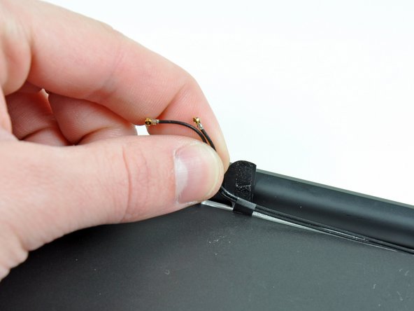

      • Peel up the six cable loops securing the antenna cables to the upper case.
      • Gently pull the cable loops slightly out of the channel cut into the upper case one at a time.
      • Use your spudger to open up the plastic loops as you de-route the antenna cables through them.
      • Repeat this for all five retaining loops.

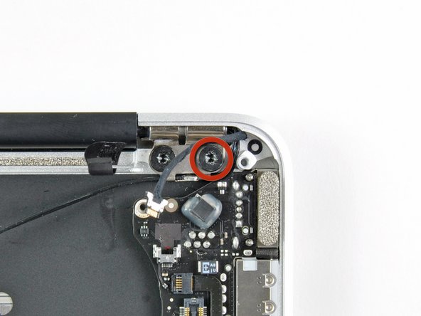

    4. MacBook Air 11" Late 2010 Upper Case Replacement: crwdns2935265:027crwdnd2935265:01crwdnd2935265:02crwdne2935265:0 MacBook Air 11" Late 2010 Upper Case Replacement: crwdns2935265:027crwdnd2935265:02crwdnd2935265:02crwdne2935265:0
      • Remove the outer 4.9 mm T8 Torx screw securing each display hinge to the upper case (two screws total).
    5. MacBook Air 11" Late 2010 Upper Case Replacement: crwdns2935265:028crwdnd2935265:01crwdnd2935265:01crwdne2935265:0
      • Open the display until it is perpendicular to the upper case and place it on a table as shown.
      • While holding the Air steady, remove the remaining 4.9 mm T8 Torx screw from the lower display bracket.
    6. MacBook Air 11" Late 2010 Upper Case Replacement: crwdns2935265:029crwdnd2935265:01crwdnd2935265:01crwdne2935265:0
      • Before removing the last display screw, be sure to hold the display and upper case steady with your other hand. Failure to do so may allow the components to fall onto the table, causing potentially expensive damage.
      • Remove the last 4.9 mm T8 Torx screw securing the display to the upper case.

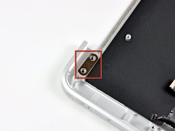

    7. MacBook Air 11" Late 2010 Upper Case Replacement: crwdns2935265:030crwdnd2935265:01crwdnd2935265:02crwdne2935265:0 MacBook Air 11" Late 2010 Upper Case Replacement: crwdns2935265:030crwdnd2935265:02crwdnd2935265:02crwdne2935265:0
      • Push the upper case slightly toward the display assembly, then rotate it away from the front of the display assembly.
      • Once the two display hinges have cleared the upper case, remove the display and set it aside.
      • Keep track of the shims under each of the two display brackets. When installing the display, be sure a shim is installed under each display bracket (against the upper case) as shown in the third picture.

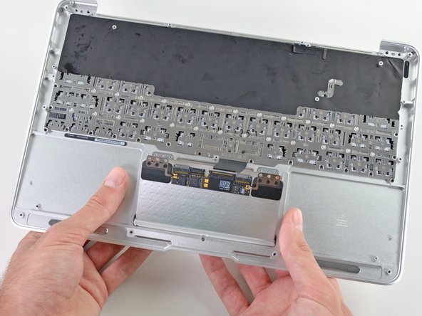

    7. MacBook Air 11" Late 2010 Upper Case Replacement: crwdns2935265:037crwdnd2935265:01crwdnd2935265:02crwdne2935265:0 MacBook Air 11" Late 2010 Upper Case Replacement: crwdns2935265:037crwdnd2935265:02crwdnd2935265:02crwdne2935265:0
      • Use the tip of a spudger to pry the microphone away from the side of the upper case.
      • Remove the microphone from the upper case.
      • Upper case remains.

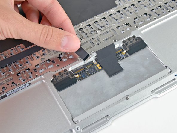

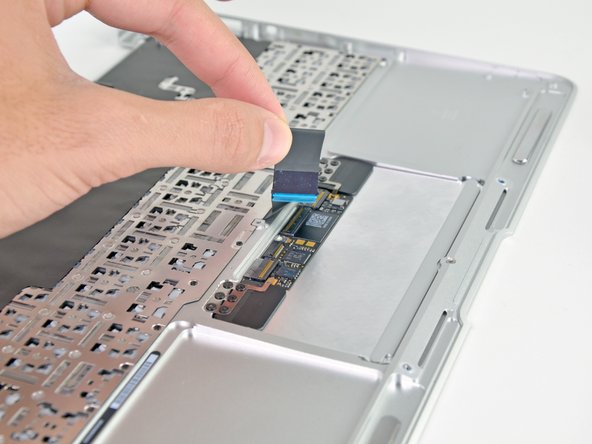

    1. MacBook Air 11" Late 2010 Upper Case Replacement, Upper Case: crwdns2935265:038crwdnd2935265:01crwdnd2935265:02crwdne2935265:0 MacBook Air 11" Late 2010 Upper Case Replacement, Upper Case: crwdns2935265:038crwdnd2935265:02crwdnd2935265:02crwdne2935265:0
      • Use the tip of a spudger to pry up the retaining flap on the trackpad data cable ZIF connector.
      • Be careful to pry on the hinged flap, not the connector itself; the connector is delicate and may break.
      • Gently slide the trackpad ribbon cable out of the ZIF connector.

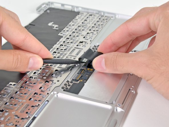

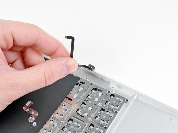

    2. MacBook Air 11" Late 2010 Upper Case Replacement: crwdns2935265:039crwdnd2935265:01crwdnd2935265:03crwdne2935265:0 MacBook Air 11" Late 2010 Upper Case Replacement: crwdns2935265:039crwdnd2935265:02crwdnd2935265:03crwdne2935265:0 MacBook Air 11" Late 2010 Upper Case Replacement: crwdns2935265:039crwdnd2935265:03crwdnd2935265:03crwdne2935265:0
      • With one hand, lift the keyboard ribbon cable up and push it slightly away from the trackpad to access the ZIF connector underneath.
      • Use a spudger tip to pry up the retaining flap on the keyboard ribbon cable ZIF connector.
      • Gently slide the keyboard ribbon cable out of the ZIF connector.

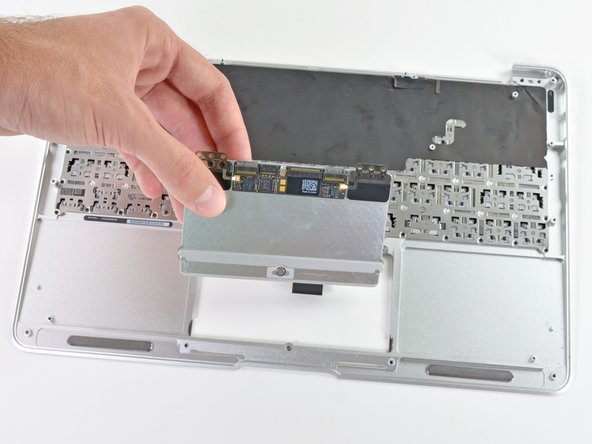

      • Remove the six 1.5 mm Phillips #00 screws that secure the trackpad assembly to the upper case.

      • While supporting the upper case, press up on the side of the trackpad closest to the logic board.
      • Remove the trackpad.

There is a T5 screw-thing in the upper case below the track pad. Adjusting this changes the play in the track pad 'click', though be careful since nothing stops it from being screwed too far in. It's not mentioned in the guide, but if you're replacing the upper case you will want to make sure the screw is installed and adjusted to your clicking taste!
netherby - crwdns2934203:0crwdne2934203:0 crwdns2950251:0crwdne2950251:0
netherby makes a good point about the tension screw for the trackpad!
This is a funny headless screw which goes in between the trackpad and the edge of the upper case. I pulled the trackpad from the old case without noticing this, reassembled to find the trackpad all weirdly loose. Tension screw fixed it.
Max Weiss - crwdns2934203:0crwdne2934203:0 crwdns2950251:0crwdne2950251:0
