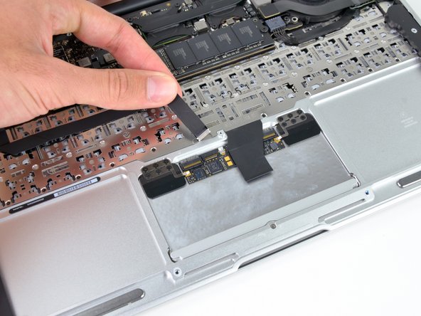

      • With one hand, lift the keyboard ribbon cable up and push it slightly away from the trackpad to access the ZIF connector underneath.
      • Use a spudger tip to pry up the retaining flap on the keyboard ribbon cable ZIF connector.
      • Be careful to pry on the hinged flap, not the connector itself; the connector is delicate and may break.
      • Gently slide the keyboard ribbon cable out of the ZIF connector.

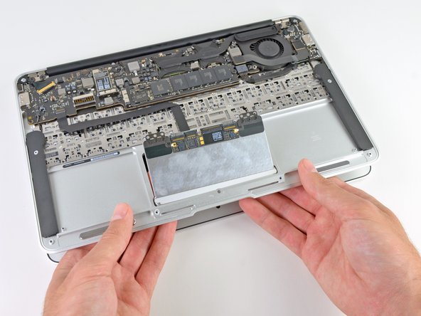

      • Open the MacBook about 10 degrees.
      • While supporting the upper case, press up on the side of the trackpad closest to the logic board.
      • Remove the trackpad.

I did it! Replaced the trackpad after the MacBook Air took a dive from a stand, which fortunately just shattered the trackpad's glass. Thanks for the easy to use instructions!
Just one note on step 8: I had to use a PH000 (triple 0) instead of the double 0 - almost destroyed one of the screws before realising.
Best regards,
StH

The trackpad from my macbook air would not click anymore. The pointer still worked, i could still tap and hoover around.
My guess was that something fell between the trackpad and the housing.
And I was right, it was a bread crumb or else of a little seed.
While following this guide, I saw that a little magnet underneath the unibody is lifting the trackpad up again, after being pushed down. Right in that tiny space was the little bugger :)
