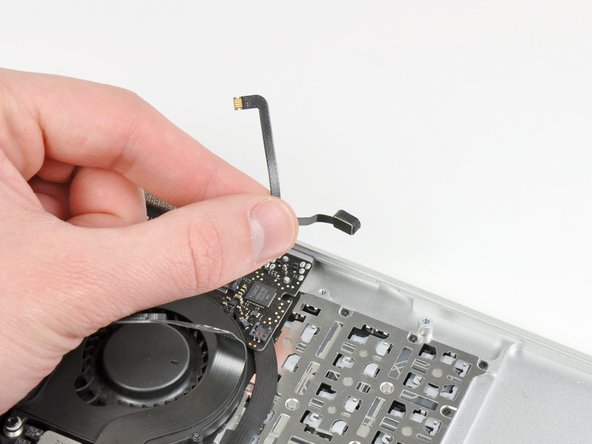

  7. MacBook Air 11" Late 2010 Microphone Replacement: crwdns2935265:07crwdnd2935265:01crwdnd2935265:03crwdne2935265:0 MacBook Air 11" Late 2010 Microphone Replacement: crwdns2935265:07crwdnd2935265:02crwdnd2935265:03crwdne2935265:0 MacBook Air 11" Late 2010 Microphone Replacement: crwdns2935265:07crwdnd2935265:03crwdnd2935265:03crwdne2935265:0
    • Use the tip of a spudger to flip up the retaining flap on the microphone ribbon cable ZIF socket.
    • Pull the microphone ribbon cable straight out of its socket.
