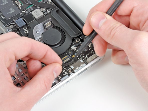

  6. MacBook Air 11" Late 2010 Left Speaker Replacement, Left Speaker: crwdns2935265:06crwdnd2935265:01crwdnd2935265:01crwdne2935265:0
    • Use the flat end of a spudger to pry the I/O board cable connector upward out of its socket on the I/O board.
  7. MacBook Air 11" Late 2010 Left Speaker Replacement: crwdns2935265:07crwdnd2935265:01crwdnd2935265:03crwdne2935265:0 MacBook Air 11" Late 2010 Left Speaker Replacement: crwdns2935265:07crwdnd2935265:02crwdnd2935265:03crwdne2935265:0 MacBook Air 11" Late 2010 Left Speaker Replacement: crwdns2935265:07crwdnd2935265:03crwdnd2935265:03crwdne2935265:0

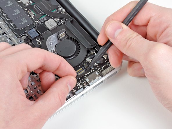

    • Use the tip of a spudger to flip up the retaining flap on the microphone ribbon cable ZIF socket.
    • Pull the microphone ribbon cable straight out of its socket.

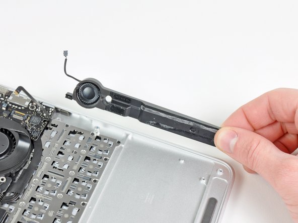

  10. MacBook Air 11" Late 2010 Left Speaker Replacement: crwdns2935265:010crwdnd2935265:01crwdnd2935265:02crwdne2935265:0 MacBook Air 11" Late 2010 Left Speaker Replacement: crwdns2935265:010crwdnd2935265:02crwdnd2935265:02crwdne2935265:0
    • Use the flat end of a spudger to pry the left speaker off the adhesive securing it to the upper case.
    • Only pry up on the speaker from the areas of bare aluminum on the upper case. Prying up from the keyboard area may damage the keyboard and the speaker itself.
    • Remove the left speaker from the upper case.
