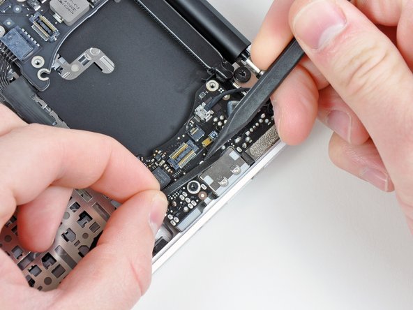

  16. MacBook Air 11" Late 2010 I/O Board Replacement: crwdns2935265:016crwdnd2935265:01crwdnd2935265:01crwdne2935265:0
    • Pull the camera cable parallel to the face of the I/O board toward the rear edge of the Air to disconnect it from its socket.
    • Do not lift upward on this cable as you disconnect it, as its socket may break off the logic board.
