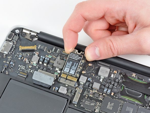

  4. MacBook Air 11" Late 2010 AirPort/Bluetooth Card Replacement, AirPort/Bluetooth Card: crwdns2935265:04crwdnd2935265:01crwdnd2935265:02crwdne2935265:0 MacBook Air 11" Late 2010 AirPort/Bluetooth Card Replacement, AirPort/Bluetooth Card: crwdns2935265:04crwdnd2935265:02crwdnd2935265:02crwdne2935265:0
    • Use the flat end of a spudger to pry both antenna connectors up from their sockets on the AirPort/Bluetooth card.
