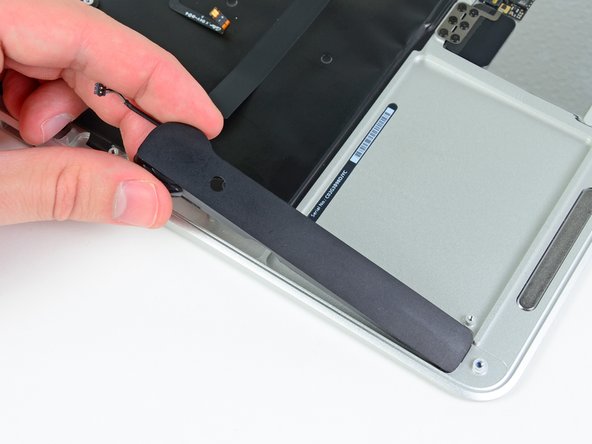

  36. MacBook Air 11" Early 2015 Upper Case Replacement: crwdns2935265:036crwdnd2935265:01crwdnd2935265:02crwdne2935265:0 MacBook Air 11" Early 2015 Upper Case Replacement: crwdns2935265:036crwdnd2935265:02crwdnd2935265:02crwdne2935265:0
    • Use the flat end of a spudger to pry the left speaker off the adhesive securing it to the upper case.
    • Only pry up on the speaker from the areas of bare aluminum on the upper case. Prying up from the keyboard area may damage the keyboard and the speaker itself.
    • Remove the left speaker from the upper case.

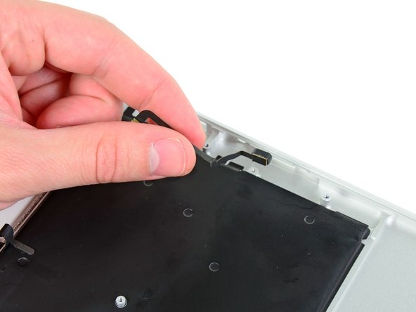

  37. MacBook Air 11" Early 2015 Upper Case Replacement: crwdns2935265:037crwdnd2935265:01crwdnd2935265:02crwdne2935265:0 MacBook Air 11" Early 2015 Upper Case Replacement: crwdns2935265:037crwdnd2935265:02crwdnd2935265:02crwdne2935265:0
    • Use the tip of a spudger to pry the microphone away from the side of the upper case.
    • Remove the microphone from the upper case.

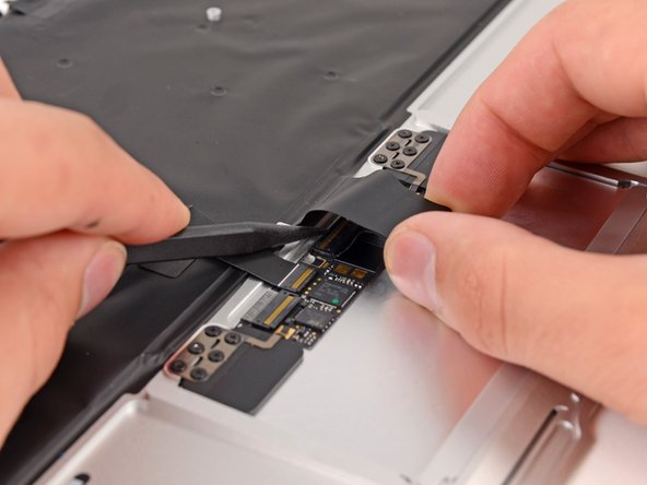

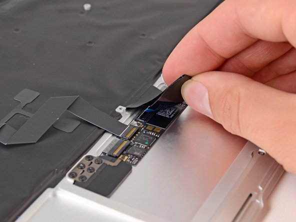

  38. MacBook Air 11" Early 2015 Upper Case Replacement, Upper Case: crwdns2935265:038crwdnd2935265:01crwdnd2935265:03crwdne2935265:0 MacBook Air 11" Early 2015 Upper Case Replacement, Upper Case: crwdns2935265:038crwdnd2935265:02crwdnd2935265:03crwdne2935265:0 MacBook Air 11" Early 2015 Upper Case Replacement, Upper Case: crwdns2935265:038crwdnd2935265:03crwdnd2935265:03crwdne2935265:0
    • The ZIF connector for the keyboard ribbon cable is hidden under the cable itself.
    • Push/lift the keyboard ribbon cable off of the upper case with one hand.
    • With the other hand, use a spudger to flip up the retaining flap on the ZIF connector.
    • Once the retaining flap has been flipped up, carefully pull the ribbon cable straight out of its socket.

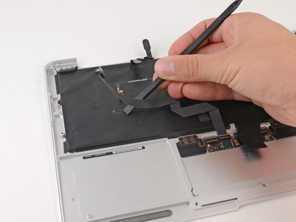

  39. MacBook Air 11" Early 2015 Upper Case Replacement: crwdns2935265:039crwdnd2935265:01crwdnd2935265:02crwdne2935265:0 MacBook Air 11" Early 2015 Upper Case Replacement: crwdns2935265:039crwdnd2935265:02crwdnd2935265:02crwdne2935265:0
    • Use the flat end of a spudger to separate the trackpad ribbon cable from the underside of the keyboard.
    • The cable is held in place with adhesive. Work carefully, and be sure to not let the spudger slip and damage any components.
