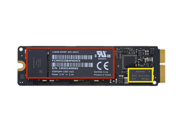

    • While the bigger, badder, 13-incher Air got a faster and flashier SSD, the 11" model is stuck in 2013 with the same old, same old.
    • Apple decides not to spread the upgrade fun; we get stuck with a geriatric, 2-year-old SSD. Bring on the extra help to get it up and out of bed.
    • With a little poking and prodding, it proceeds to spill the beans—er, chips. In fact, they're very much the same chips we dipped into on the mid-2013 version:
    • 8 x SanDisk 05131 016G 16 GB NAND flash memory (128 GB total)
    • Marvell 88SS9183 PCIe SSD controller
    • Samsung K4B2G1646E 2 Gb (256 MB) DDR3 SDRAM

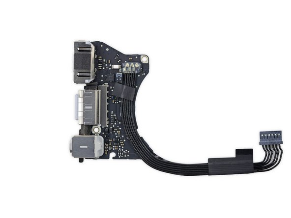

    • We are airing the differences in these lightweight notebooks, and the last thing to come to the table is the I/O board.
    • With a light touch, we remove the I/O board for a better look at the headphone jack, a USB port, and the MagSafe 2 port.

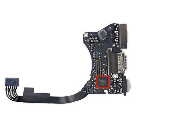

    • A passing glance at the board reveals the same Cirrus Logic 4208-CRZ HD audio codec found in this year's 13" model (likely similar to the 4207).
