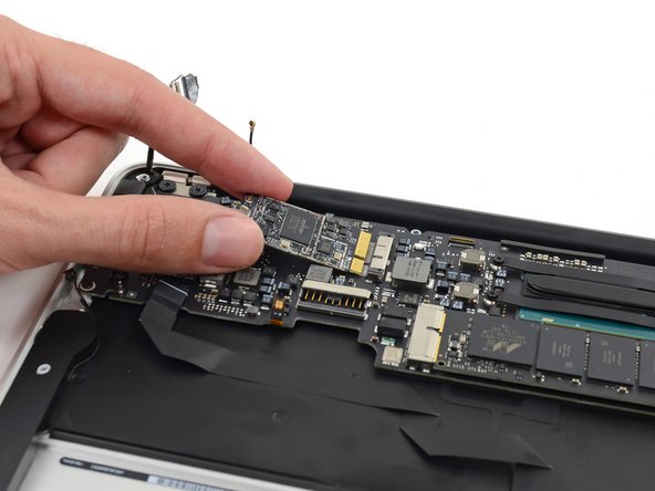

  21. MacBook Air 11" Early 2015 Logic Board Replacement: crwdns2935265:021crwdnd2935265:01crwdnd2935265:03crwdne2935265:0 MacBook Air 11" Early 2015 Logic Board Replacement: crwdns2935265:021crwdnd2935265:02crwdnd2935265:03crwdne2935265:0 MacBook Air 11" Early 2015 Logic Board Replacement: crwdns2935265:021crwdnd2935265:03crwdnd2935265:03crwdne2935265:0
    • Slightly lift the free end of the AirPort/Bluetooth board and pull it out of its socket on the logic board.
    • To avoid damaging its socket on the logic board, do not excessively lift the free end of the AirPort/Bluetooth card.
