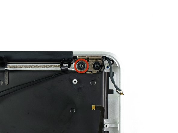

  31. MacBook Air 11" Early 2014 Display Assembly Replacement: crwdns2935265:031crwdnd2935265:01crwdnd2935265:02crwdne2935265:0 MacBook Air 11" Early 2014 Display Assembly Replacement: crwdns2935265:031crwdnd2935265:02crwdnd2935265:02crwdne2935265:0
    • Remove the inner 4.9 mm T8 Torx screw securing each display hinge to the upper case (two screws total).
  32. MacBook Air 11" Early 2014 Display Assembly Replacement: crwdns2935265:032crwdnd2935265:01crwdnd2935265:01crwdne2935265:0
    • Open the display until it is perpendicular to the upper case and place it on a table as shown.
    • While holding the Air steady, remove the remaining 4.9 mm T8 Torx screw from the lower display bracket.
  33. MacBook Air 11" Early 2014 Display Assembly Replacement: crwdns2935265:033crwdnd2935265:01crwdnd2935265:01crwdne2935265:0
    • Before removing the last display screw, be sure to hold the display and upper case steady with your other hand. Failure to do so may allow the components to fall onto the table, causing potentially expensive damage.
    • Remove the last 4.9 mm T8 Torx screw securing the display to the upper case.
  34. MacBook Air 11" Early 2014 Display Assembly Replacement: crwdns2935265:034crwdnd2935265:01crwdnd2935265:02crwdne2935265:0 MacBook Air 11" Early 2014 Display Assembly Replacement: crwdns2935265:034crwdnd2935265:02crwdnd2935265:02crwdne2935265:0
    • Push the upper case slightly toward the display assembly, then rotate it away from the front of the display assembly.
    • Once the two display hinges have cleared the upper case, remove the display.
