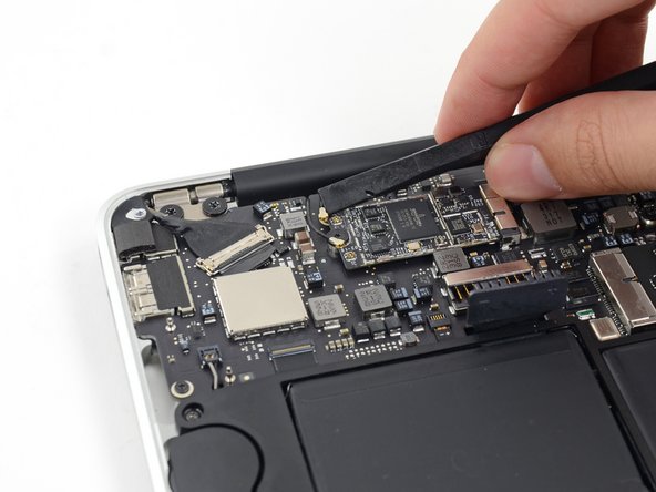

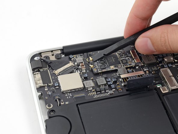

  4. MacBook Air 11" Early 2014 AirPort/Bluetooth Board Replacement, AirPort/Bluetooth Board: crwdns2935265:04crwdnd2935265:01crwdnd2935265:03crwdne2935265:0 MacBook Air 11" Early 2014 AirPort/Bluetooth Board Replacement, AirPort/Bluetooth Board: crwdns2935265:04crwdnd2935265:02crwdnd2935265:03crwdne2935265:0 MacBook Air 11" Early 2014 AirPort/Bluetooth Board Replacement, AirPort/Bluetooth Board: crwdns2935265:04crwdnd2935265:03crwdnd2935265:03crwdne2935265:0
    • Use the flat end of a spudger to pry both antenna connectors up from their sockets on the AirPort/Bluetooth card, and move them out of the way of the card.
