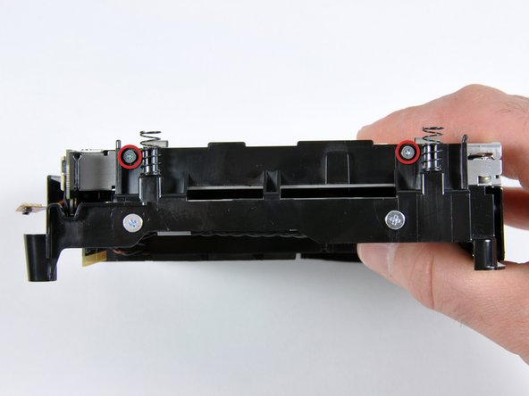

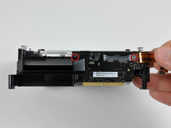

  7. Mac mini Model A1283 Terabyte Drive Replacement: crwdns2935265:07crwdnd2935265:01crwdnd2935265:02crwdne2935265:0 Mac mini Model A1283 Terabyte Drive Replacement: crwdns2935265:07crwdnd2935265:02crwdnd2935265:02crwdne2935265:0
    • Remove the black Phillips screw located on the upper right corner.
    • Remove the black Phillips screw located on the bottom right corner.
  8. Mac mini Model A1283 Terabyte Drive Replacement: crwdns2935265:08crwdnd2935265:01crwdnd2935265:03crwdne2935265:0 Mac mini Model A1283 Terabyte Drive Replacement: crwdns2935265:08crwdnd2935265:02crwdnd2935265:03crwdne2935265:0 Mac mini Model A1283 Terabyte Drive Replacement: crwdns2935265:08crwdnd2935265:03crwdnd2935265:03crwdne2935265:0
    • Remove the two silver Phillips screws holding the SuperDrive to the internal frame.
    • Rotate the internal frame 180 degrees and remove two more silver Phillips screws.
    • Rotate the internal frame so that the interconnect board connector is facing you.
    • Remove the two silver Phillips screws holding the SuperDrive to the interconnect board connector.
