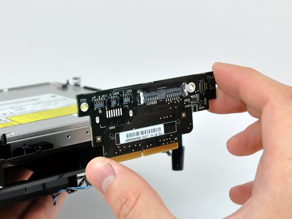

  18. Mac mini Model A1283 Interconnect Board Replacement: crwdns2935265:018crwdnd2935265:01crwdnd2935265:02crwdne2935265:0 Mac mini Model A1283 Interconnect Board Replacement: crwdns2935265:018crwdnd2935265:02crwdnd2935265:02crwdne2935265:0
    • Use the flat end of a spudger to separate the interconnect board from the optical and hard drives.
    • Pull the interconnect board away from the drives and remove it from the internal frame.
