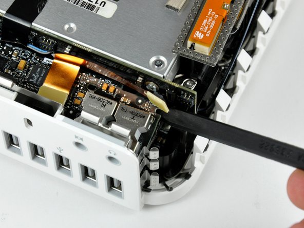

  7. Mac mini Model A1283 Audio Board Replacement, Audio Board: crwdns2935265:07crwdnd2935265:01crwdnd2935265:01crwdne2935265:0
    • Remove the single Phillips screw between the headphone and microphone jacks on the audio board.
  8. Mac mini Model A1283 Audio Board Replacement: crwdns2935265:08crwdnd2935265:01crwdnd2935265:01crwdne2935265:0
    • Use the flat end of a spudger to pry the audio ribbon cable connector off the interconnect board.
  9. Mac mini Model A1283 Audio Board Replacement: crwdns2935265:09crwdnd2935265:01crwdnd2935265:02crwdne2935265:0 Mac mini Model A1283 Audio Board Replacement: crwdns2935265:09crwdnd2935265:02crwdnd2935265:02crwdne2935265:0
    • Use the tip of a spudger to depress the audio board retaining clip (shown in red) to release the audio board from the bottom housing.
    • Lift the audio board from its free end and remove it from the mini.
    • Don't forget to transfer the audio ribbon cable to your new audio board.
