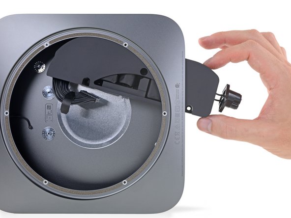

  7. Mac mini Late 2018 Teardown: crwdns2935265:07crwdnd2935265:01crwdnd2935265:03crwdne2935265:0 Mac mini Late 2018 Teardown: crwdns2935265:07crwdnd2935265:02crwdnd2935265:03crwdne2935265:0 Mac mini Late 2018 Teardown: crwdns2935265:07crwdnd2935265:03crwdnd2935265:03crwdne2935265:0
    • Just one connector and two screws sets the little system speaker free.
    • iMac and MacBook speakers seem to be getting bigger all the time, but this one looks about the same size as in older Mac minis.
    • Beneath the speaker, we find some antenna cables, but unfortunately no modular AirPort card—in what is becoming a trend, these are socketed right to the main board.
    • Alas, AirPort cards are just a distant memory now that logic boards have assimilated all wireless functions.
    • From here we set to work freeing the heatsink, twirling away Torx screws and exposing the paste-y (soldered) CPU.
    • One last screw, and the port cover is free, uncovering ... the ports. As it departs, it takes some antenna hardware with it.

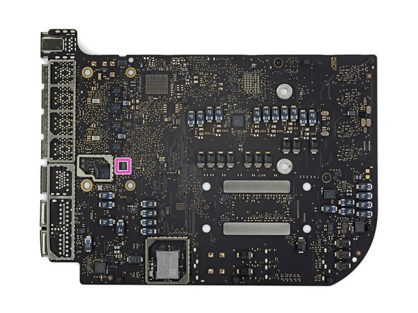

  10. Mac mini Late 2018 Teardown: crwdns2935265:010crwdnd2935265:01crwdnd2935265:02crwdne2935265:0 Mac mini Late 2018 Teardown: crwdns2935265:010crwdnd2935265:02crwdnd2935265:02crwdne2935265:0
    • Chip identification, continued:
    • Infineon (formerly International Rectifier) IRF3575 60 A synchronous buck converter
    • Renesas (formerly Intersil) ISL62383C power supply controller
    • Vishay SIC621 60 A integrated power stage
    • Renesas (formerly Intersil) ISL80101A 1 A LDO regulator
    • Texas Instruments INA210 bi-directional current sense amplifier
    • Texas Instruments INA211 bi-directional current sense amplifier
    • Texas Instruments INA214 bi-directional current sense amplifier
  11. Mac mini Late 2018 Teardown: crwdns2935265:011crwdnd2935265:01crwdnd2935265:02crwdne2935265:0 Mac mini Late 2018 Teardown: crwdns2935265:011crwdnd2935265:02crwdnd2935265:02crwdne2935265:0
    • Dialog Semiconductor (formerly Adesto) AT45DB021E 2 MB serial flash memory
    • Macronix MX25R2035F 2 MB serial NOR flash memory
    • Winbond W25Q80EW 8 MB serial NOR flash memory
    • Winbond W25Q80DW 8 MB serial NOR flash memory
    • ON Semiconductor CAT24C128 128 KB serial EEPROM memory
    • Texas Instruments HD3SS215 6.0 Gbps HDMI DisplayPort differential switch
    • Diodes Incorporated PI3USB32 dual SPST USB 2.0 switch
