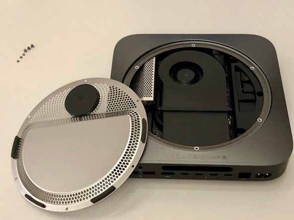

  2. Mac mini Late 2018 Disassembly, Lets flip it over: crwdns2935265:02crwdnd2935265:01crwdnd2935265:03crwdne2935265:0 Mac mini Late 2018 Disassembly, Lets flip it over: crwdns2935265:02crwdnd2935265:02crwdnd2935265:03crwdne2935265:0 Mac mini Late 2018 Disassembly, Lets flip it over: crwdns2935265:02crwdnd2935265:03crwdnd2935265:03crwdne2935265:0
    • Once flipped over, a familiar black cover is revealed.
    • Pry open the lid to release it from the three large screws
    • The lid had a soft foam inside to dampen the vibrations of the beefed up fan
  3. Mac mini Late 2018 Disassembly, Take off the metal cover: crwdns2935265:03crwdnd2935265:01crwdnd2935265:02crwdne2935265:0 Mac mini Late 2018 Disassembly, Take off the metal cover: crwdns2935265:03crwdnd2935265:02crwdnd2935265:02crwdne2935265:0

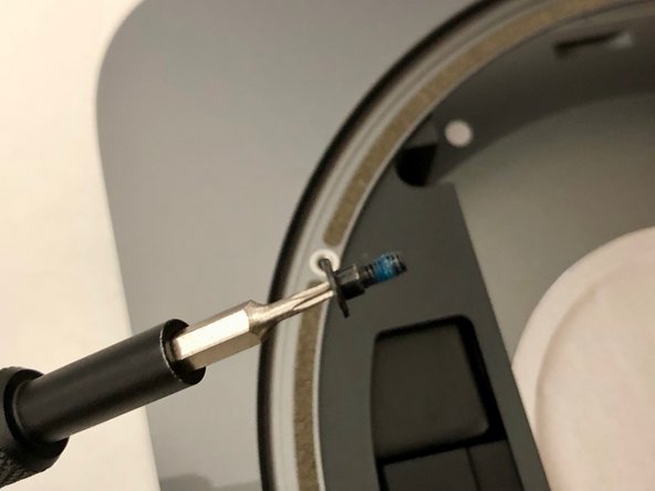

    • The lid is secured with the same TR6 screws as the 2014 model
  4. Mac mini Late 2018 Disassembly, Reveal the innards: crwdns2935265:04crwdnd2935265:01crwdnd2935265:02crwdne2935265:0 Mac mini Late 2018 Disassembly, Reveal the innards: crwdns2935265:04crwdnd2935265:02crwdnd2935265:02crwdne2935265:0
    • The antenna cable is very short, so watch out; rotate the cover to reveal the internals

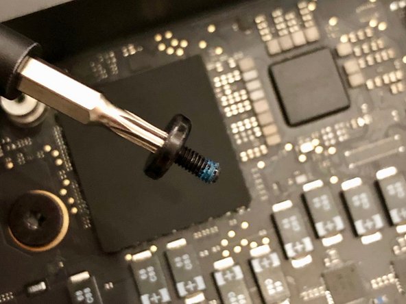

  5. Mac mini Late 2018 Disassembly, Antenna cable: crwdns2935265:05crwdnd2935265:01crwdnd2935265:02crwdne2935265:0 Mac mini Late 2018 Disassembly, Antenna cable: crwdns2935265:05crwdnd2935265:02crwdnd2935265:02crwdne2935265:0
    • The antenna cable is held down with a little TX6 screw
    • It has a tiny washer to make sure no stress is applied to the cable

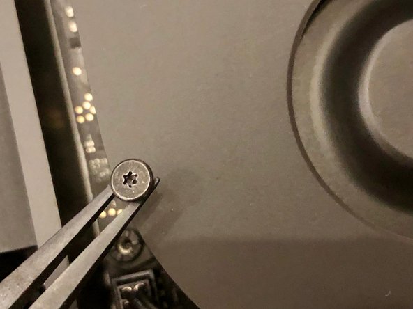

  6. Mac mini Late 2018 Disassembly, Take off the fan: crwdns2935265:06crwdnd2935265:01crwdnd2935265:03crwdne2935265:0 Mac mini Late 2018 Disassembly, Take off the fan: crwdns2935265:06crwdnd2935265:02crwdnd2935265:03crwdne2935265:0 Mac mini Late 2018 Disassembly, Take off the fan: crwdns2935265:06crwdnd2935265:03crwdnd2935265:03crwdne2935265:0

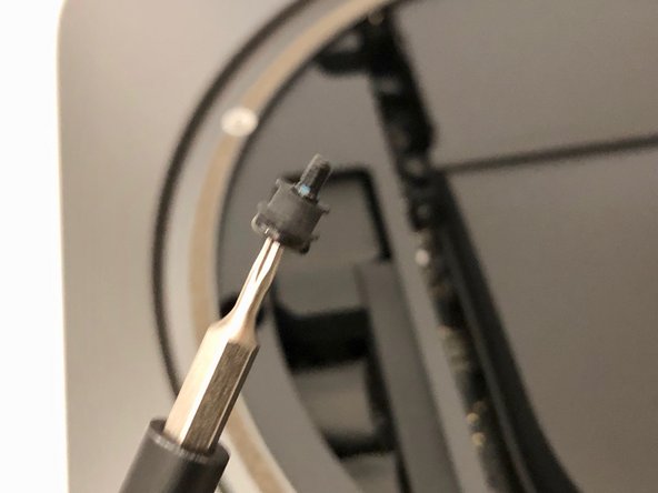

    • The fan has four identical TX6 screws holding it down
    • The screws go trough a rubber tube to reduce vibration

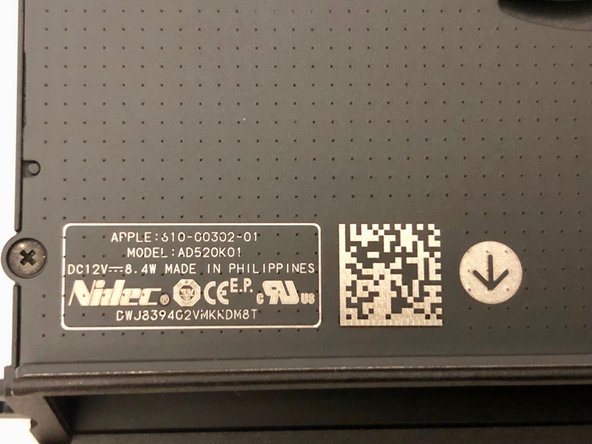

    • Underneath the fan the connector pops off easilly
    • The fan feels solid. Much better than previous models

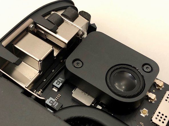

    • Some interesting design choices made here. A full size CMOS battery
    • The wifi wiring runs underneath the large speaker
    • The power button is attached to a ultra flat cable that runs in an arc along the heatsink

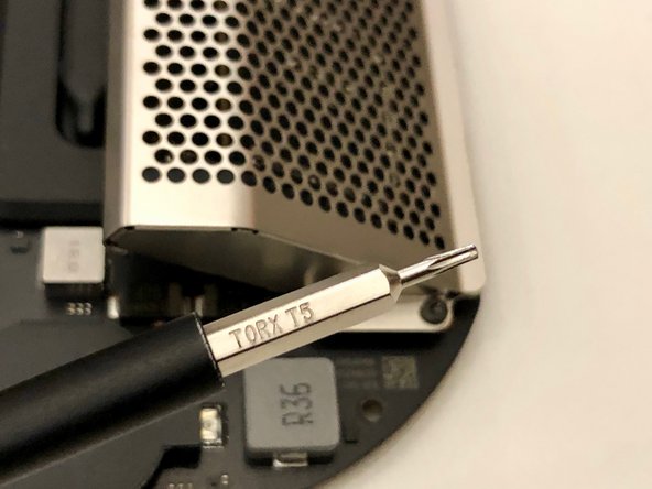

  13. Mac mini Late 2018 Disassembly, Memory cover: crwdns2935265:013crwdnd2935265:01crwdnd2935265:03crwdne2935265:0 Mac mini Late 2018 Disassembly, Memory cover: crwdns2935265:013crwdnd2935265:02crwdnd2935265:03crwdne2935265:0 Mac mini Late 2018 Disassembly, Memory cover: crwdns2935265:013crwdnd2935265:03crwdnd2935265:03crwdne2935265:0

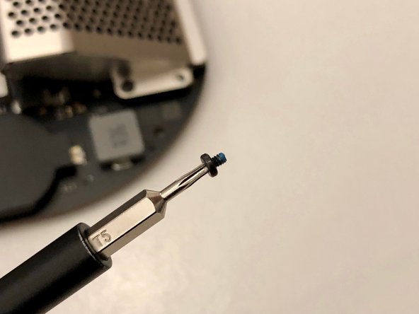

    • But now what we are all here for. The RAM
    • Four TX5 screws holt it down
  14. Mac mini Late 2018 Disassembly, Slide off the cover: crwdns2935265:014crwdnd2935265:01crwdnd2935265:03crwdne2935265:0 Mac mini Late 2018 Disassembly, Slide off the cover: crwdns2935265:014crwdnd2935265:02crwdnd2935265:03crwdne2935265:0 Mac mini Late 2018 Disassembly, Slide off the cover: crwdns2935265:014crwdnd2935265:03crwdnd2935265:03crwdne2935265:0

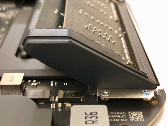

    • These rubber parts will be a pain to put back on later.
    • There are tiny pieces of rubber in it that need to slide into the metal clips holding the memory in place

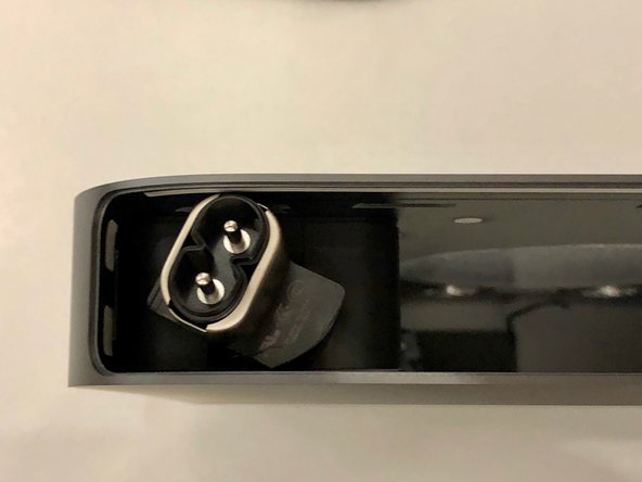

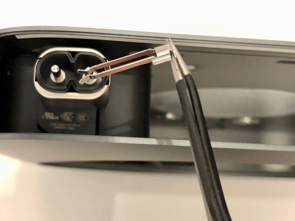

  17. Mac mini Late 2018 Disassembly, Power supply connector: crwdns2935265:017crwdnd2935265:01crwdnd2935265:03crwdne2935265:0 Mac mini Late 2018 Disassembly, Power supply connector: crwdns2935265:017crwdnd2935265:02crwdnd2935265:03crwdne2935265:0 Mac mini Late 2018 Disassembly, Power supply connector: crwdns2935265:017crwdnd2935265:03crwdnd2935265:03crwdne2935265:0

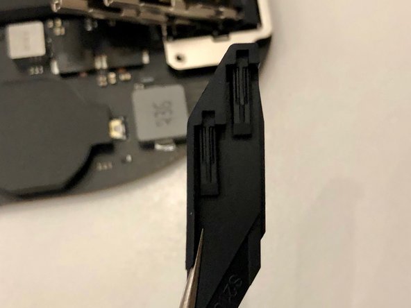

    • The power supply is secured in a similar way as with the previous models
    • A little clip has to be removed, and the connector can be rotated
