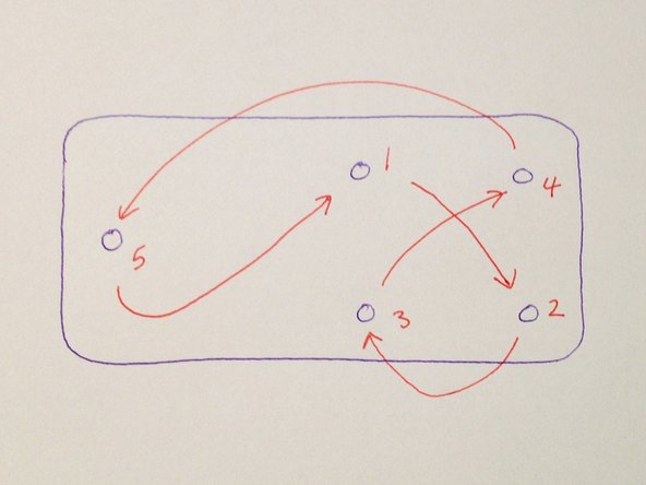

  6. Mac Pro Single CPU Northbridge Heatsink Repair: crwdns2935265:06crwdnd2935265:01crwdnd2935265:02crwdne2935265:0 Mac Pro Single CPU Northbridge Heatsink Repair: crwdns2935265:06crwdnd2935265:02crwdnd2935265:02crwdne2935265:0
    • Use a 3 mm hexagonal wrench to release the heatsink. The wrench must be at least 15 cm long.
    • Release the holding bolts ONE TURN at a time, following an X pattern (top left, bottom right, top right, bottom left, far left) and continue until you hear a release click. Note: do not completely undo one bolt and then move to the next. Instead, repeat this pattern, making one turn at a time, until the heatsink is released from the PCB.
    • When you replace the heatsink use the same pattern to tighten the bolts. Do not tighten more than finger tight. Make sure that the same tension is applied to each of the bolts. Uneven pressure can result in the CPU contacts failing. Symptoms range from boot-failure to missing or malfunctioning memory cards.

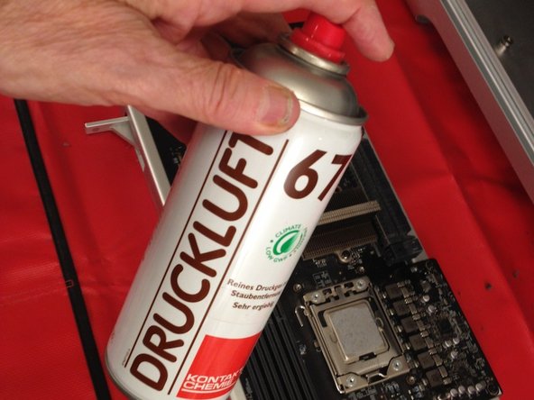

  7. Mac Pro Single CPU Northbridge Heatsink Repair: crwdns2935265:07crwdnd2935265:01crwdnd2935265:02crwdne2935265:0 Mac Pro Single CPU Northbridge Heatsink Repair: crwdns2935265:07crwdnd2935265:02crwdnd2935265:02crwdne2935265:0
    • Dust acts like a blanket that keeps the PCB warm, contributing to the possibility of overheating. The PCB and heatsinks, fans, case interior and so on should be cleaned regularly. Take this opportunity to clean the board.
    • Use an anti-static brush. Do not use any brush, for most brushes will cause static charge to build up and can damage the electronic components. Compressed air is also useful, especially for cleaning out the CPU heatsink.

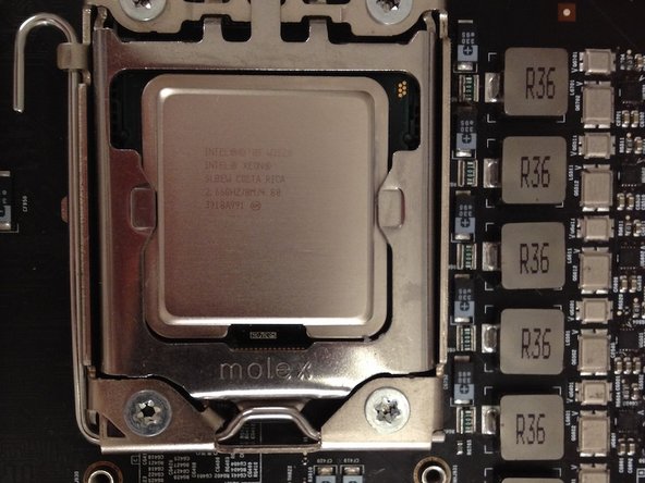

  14. Mac Pro Single CPU Northbridge Heatsink Repair: crwdns2935265:014crwdnd2935265:01crwdnd2935265:02crwdne2935265:0 Mac Pro Single CPU Northbridge Heatsink Repair: crwdns2935265:014crwdnd2935265:02crwdnd2935265:02crwdne2935265:0
    • Use Thermal Material Remover to clean the chips and the heatsinks of the old thermal paste. Clean off both the CPU and northbridge chips. Wipe off the occluding surfaces with lint-free cloth.
    • Take care not to drop anything on the northbridge. It is not protected with a steel lid.
    • Open the latch on the processor cradle to clean around the CPU chip. Don't remove the CPU chip. That would be an unnecessary risk and there is nothing to clean underneath.
