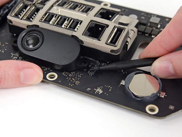

  31. Mac Pro Late 2013 Speaker Replacement, Speaker: crwdns2935265:031crwdnd2935265:01crwdnd2935265:02crwdne2935265:0 Mac Pro Late 2013 Speaker Replacement, Speaker: crwdns2935265:031crwdnd2935265:02crwdnd2935265:02crwdne2935265:0
    • Use the tip of a spudger to disconnect the speaker cable from its socket on the IO board.
    • Be careful to pry up on the connector and not the socket.
  32. Mac Pro Late 2013 Speaker Replacement: crwdns2935265:032crwdnd2935265:01crwdnd2935265:01crwdne2935265:0
    • Remove the two 3.2 mm T4 Torx screws securing the speaker to the IO board.
  33. Mac Pro Late 2013 Speaker Replacement: crwdns2935265:033crwdnd2935265:01crwdnd2935265:01crwdne2935265:0
    • Remove the speaker from the IO board.
