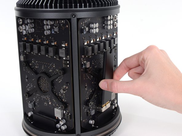

  3. Mac Pro Late 2013 SSD Replacement, SSD: crwdns2935265:03crwdnd2935265:01crwdnd2935265:01crwdne2935265:0
    • Remove the single 6.5 mm T8 Torx screw.
  4. Mac Pro Late 2013 SSD Replacement: crwdns2935265:04crwdnd2935265:01crwdnd2935265:03crwdne2935265:0 Mac Pro Late 2013 SSD Replacement: crwdns2935265:04crwdnd2935265:02crwdnd2935265:03crwdne2935265:0 Mac Pro Late 2013 SSD Replacement: crwdns2935265:04crwdnd2935265:03crwdnd2935265:03crwdne2935265:0
    • Pull the SSD slightly away from the graphics card.
    • Do not pull the top edge of the SSD more than 1/2" away from the graphics card, or you will risk damaging it.
    • Lift the SSD straight up out of its slot on the graphics card.

Will a 970 evo 512 gb pcie m2 fit on here?
Sam Yao - crwdns2934203:0crwdne2934203:0
As long as the drive is not the Plus version, you may be able to use an adapter in order to use that SSD in your MacPro6,1:
https://www.amazon.com/Sintech-Adapter-U...
I have not tried this, but am, currently, researching a fix for a machine in my care.
Robert Maxwell -
Yes—works very well with the Sintech adaptor (and even with an EK-M.2 NVMe Heatsink — use thermal paste for longevity!).
Just did this yesterday and it’s a great/fast/easy upgrade.
ericbalog -
Do you need a heat sink in the SSD?
Cesar Cuenca - crwdns2934203:0crwdne2934203:0
The stock (Samsung) drive(s) that shipped (from Apple) with these machines do not; unless the black, outer covering helps with heat. [???]
I have had both a Samsung MZ-JPU256T/0A1 (256GB) and Samsung MZ-KPU1T0T/0A1 (1TB) installed in my machine without issue.
Third-party drives may include or heatsink and/or require at least 10.13 (High Sierra).
