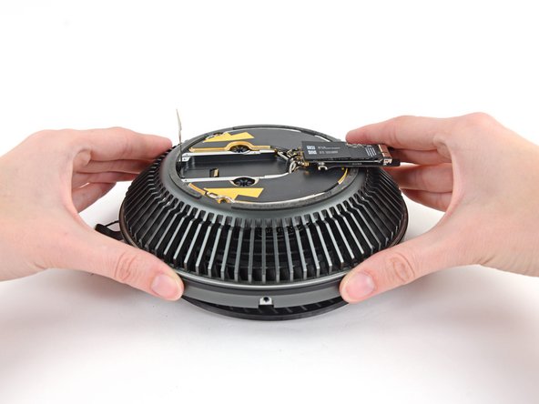

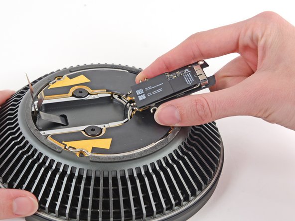

    • Flip the AirPort board over.
  18. Mac Pro Late 2013 Fan Replacement: crwdns2935265:018crwdnd2935265:01crwdnd2935265:01crwdne2935265:0
    • Remove the remaining two 10.4 mm T10 screws securing the fan to the fan assembly.

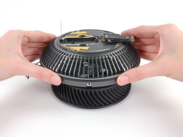

  19. Mac Pro Late 2013 Fan Replacement: crwdns2935265:019crwdnd2935265:01crwdnd2935265:03crwdne2935265:0 Mac Pro Late 2013 Fan Replacement: crwdns2935265:019crwdnd2935265:02crwdnd2935265:03crwdne2935265:0 Mac Pro Late 2013 Fan Replacement: crwdns2935265:019crwdnd2935265:03crwdnd2935265:03crwdne2935265:0
    • Lift the fan assembly up from the fan.
