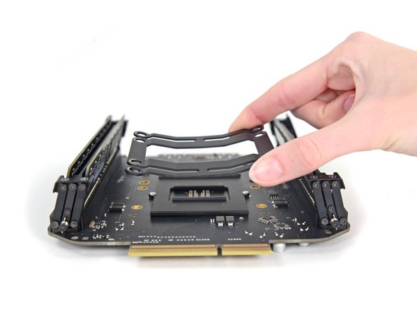

    4. Mac Pro Late 2013 CPU Replacement: crwdns2935265:025crwdnd2935265:01crwdnd2935265:02crwdne2935265:0 Mac Pro Late 2013 CPU Replacement: crwdns2935265:025crwdnd2935265:02crwdnd2935265:02crwdne2935265:0
      • Remove the inner four 12.8 mm T10 Torx screws from the CPU heat sink bracket.
      • Remove the CPU heat sink bracket.
    5. Mac Pro Late 2013 CPU Replacement: crwdns2935265:026crwdnd2935265:01crwdnd2935265:01crwdne2935265:0
      • Remove the second heat sink bracket.
    6. Mac Pro Late 2013 CPU Replacement: crwdns2935265:027crwdnd2935265:01crwdnd2935265:02crwdne2935265:0 Mac Pro Late 2013 CPU Replacement: crwdns2935265:027crwdnd2935265:02crwdnd2935265:02crwdne2935265:0
      • Lift and remove the logic board from the CPU and bracket.
      • During reassembly, be sure to clean off and replace the thermal compound on the CPU.
      • We have a thermal paste guide that makes replacing the thermal compound easy.
