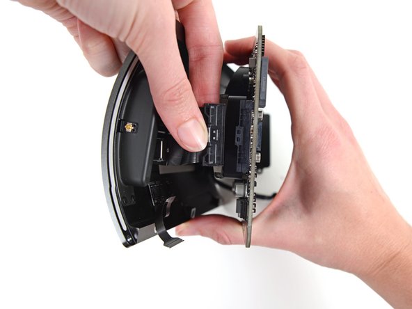

    • The fan assembly is attached to the rest of the computer by two cables on the IO board side.
    • Tilt the assembly up away from the IO board.
    • Do not try to remove the fan assembly yet, as it is still attached by two cables.

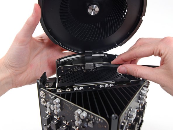

  6. Mac Pro Late 2013 CMOS Battery Replacement: crwdns2935265:06crwdnd2935265:01crwdnd2935265:01crwdne2935265:0
    • Use a pair of tweezers to pull the fan cable bracket away from the fan assembly.
  7. Mac Pro Late 2013 CMOS Battery Replacement: crwdns2935265:07crwdnd2935265:01crwdnd2935265:02crwdne2935265:0 Mac Pro Late 2013 CMOS Battery Replacement: crwdns2935265:07crwdnd2935265:02crwdnd2935265:02crwdne2935265:0
    • Use the flat end of a spudger to disconnect the fan assembly ribbon cable from the IO board.
  8. Mac Pro Late 2013 CMOS Battery Replacement: crwdns2935265:08crwdnd2935265:01crwdnd2935265:01crwdne2935265:0
    • Disconnect the fan assembly antenna cable from the IO board.
    • Remove the fan assembly from the Mac Pro.

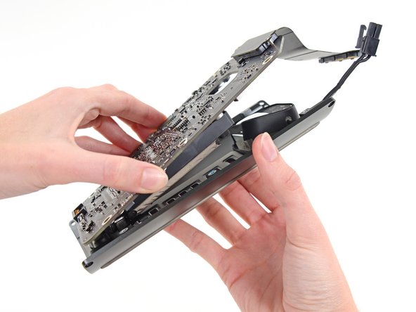

  23. Mac Pro Late 2013 CMOS Battery Replacement: crwdns2935265:023crwdnd2935265:01crwdnd2935265:02crwdne2935265:0 Mac Pro Late 2013 CMOS Battery Replacement: crwdns2935265:023crwdnd2935265:02crwdnd2935265:02crwdne2935265:0
    • Remove the four 9.0 mm silver T10 Torx screws from the sides of the power supply.
    • The power supply overhangs these screws somewhat, so you'll need to use a fixed screwdriver at a bit of an angle.
  24. Mac Pro Late 2013 CMOS Battery Replacement: crwdns2935265:024crwdnd2935265:01crwdnd2935265:02crwdne2935265:0 Mac Pro Late 2013 CMOS Battery Replacement: crwdns2935265:024crwdnd2935265:02crwdnd2935265:02crwdne2935265:0
    • Gently shift the power supply to free the AC power inlet cable out of its plastic clip.
    • Be careful not to try to separate the power supply from the IO board assembly just yet, as it is still connected by the AC power inlet cable.
  25. Mac Pro Late 2013 CMOS Battery Replacement: crwdns2935265:025crwdnd2935265:01crwdnd2935265:02crwdne2935265:0 Mac Pro Late 2013 CMOS Battery Replacement: crwdns2935265:025crwdnd2935265:02crwdnd2935265:02crwdne2935265:0

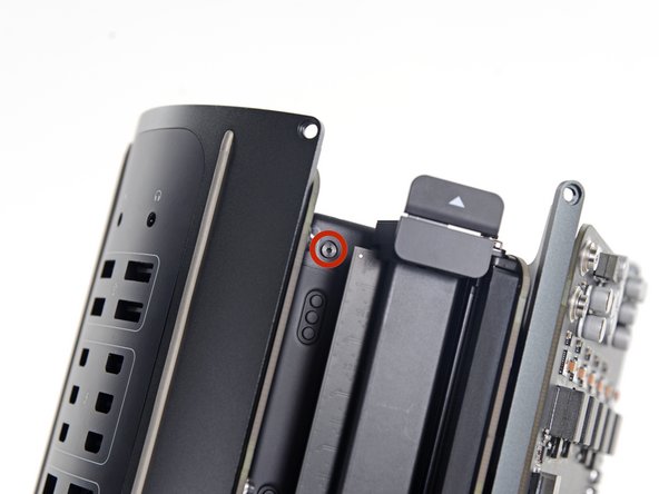

  27. Mac Pro Late 2013 CMOS Battery Replacement, IO Board: crwdns2935265:027crwdnd2935265:01crwdnd2935265:01crwdne2935265:0
    • Remove the two 9 mm silver T10 Torx screws securing the IO Board to the IO shield.
  28. Mac Pro Late 2013 CMOS Battery Replacement: crwdns2935265:028crwdnd2935265:01crwdnd2935265:02crwdne2935265:0 Mac Pro Late 2013 CMOS Battery Replacement: crwdns2935265:028crwdnd2935265:02crwdnd2935265:02crwdne2935265:0
    • Lift the IO board up from the IO shield from the end with the AC plug.
    • Do not attempt to completely separate the IO board from the IO shield, as there are still two cables connecting the two components.
  29. Mac Pro Late 2013 CMOS Battery Replacement: crwdns2935265:029crwdnd2935265:01crwdnd2935265:03crwdne2935265:0 Mac Pro Late 2013 CMOS Battery Replacement: crwdns2935265:029crwdnd2935265:02crwdnd2935265:03crwdne2935265:0 Mac Pro Late 2013 CMOS Battery Replacement: crwdns2935265:029crwdnd2935265:03crwdnd2935265:03crwdne2935265:0
