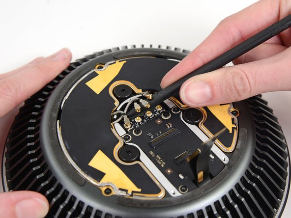

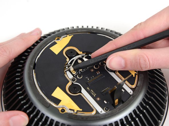

  14. Mac Pro Late 2013 AirPort Card Replacement, AirPort Card: crwdns2935265:014crwdnd2935265:01crwdnd2935265:03crwdne2935265:0 Mac Pro Late 2013 AirPort Card Replacement, AirPort Card: crwdns2935265:014crwdnd2935265:02crwdnd2935265:03crwdne2935265:0 Mac Pro Late 2013 AirPort Card Replacement, AirPort Card: crwdns2935265:014crwdnd2935265:03crwdnd2935265:03crwdne2935265:0
    • Use the tip of a spudger to disconnect the four AirPort antenna cables from the AirPort card.

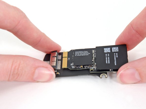

  17. Mac Pro Late 2013 AirPort Card Replacement: crwdns2935265:017crwdnd2935265:01crwdnd2935265:01crwdne2935265:0
    • Remove the two 3.7 mm T4 Torx screws securing the AirPort card to the AirPort board.
  18. Mac Pro Late 2013 AirPort Card Replacement: crwdns2935265:018crwdnd2935265:01crwdnd2935265:02crwdne2935265:0 Mac Pro Late 2013 AirPort Card Replacement: crwdns2935265:018crwdnd2935265:02crwdnd2935265:02crwdne2935265:0
    • Slide the AirPort card out of its socket in the AirPort board.
