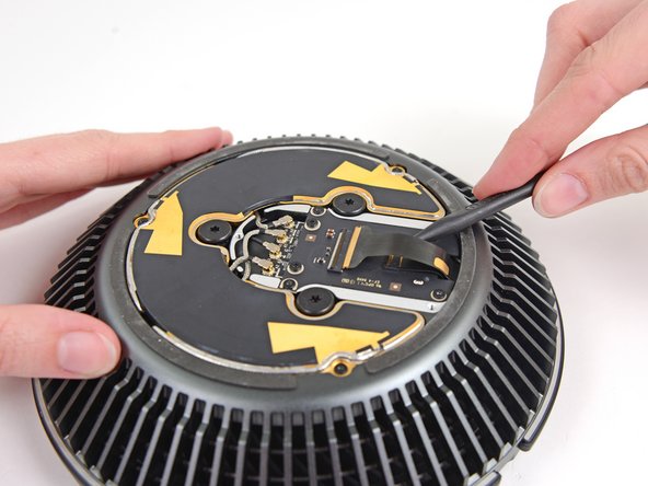

  12. Mac Pro Late 2013 AirPort Antenna Array Replacement: crwdns2935265:012crwdnd2935265:01crwdnd2935265:03crwdne2935265:0 Mac Pro Late 2013 AirPort Antenna Array Replacement: crwdns2935265:012crwdnd2935265:02crwdnd2935265:03crwdne2935265:0 Mac Pro Late 2013 AirPort Antenna Array Replacement: crwdns2935265:012crwdnd2935265:03crwdnd2935265:03crwdne2935265:0
    • Use the tip of a spudger to flip the ZIF retaining tab on the fan assembly ribbon cable connector.
    • Remove the fan assembly ribbon cable from its ZIF socket.

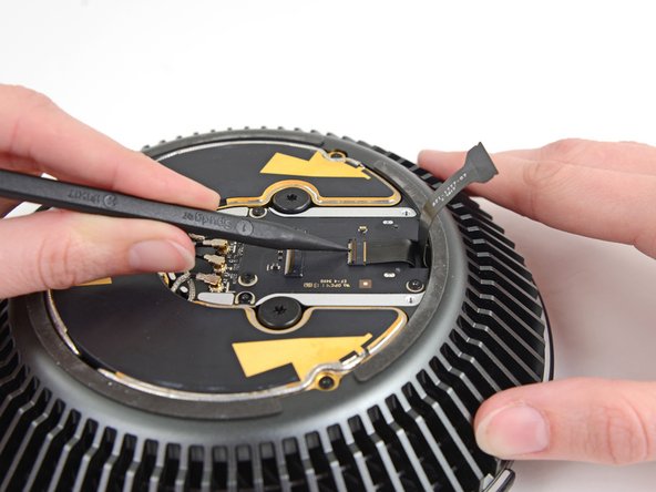

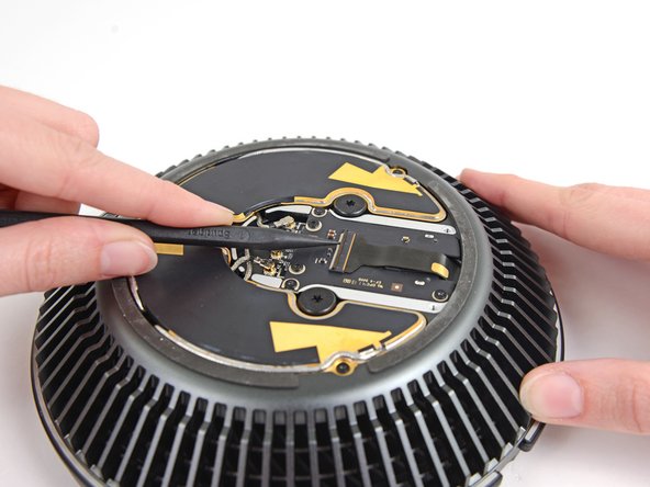

  13. Mac Pro Late 2013 AirPort Antenna Array Replacement: crwdns2935265:013crwdnd2935265:01crwdnd2935265:03crwdne2935265:0 Mac Pro Late 2013 AirPort Antenna Array Replacement: crwdns2935265:013crwdnd2935265:02crwdnd2935265:03crwdne2935265:0 Mac Pro Late 2013 AirPort Antenna Array Replacement: crwdns2935265:013crwdnd2935265:03crwdnd2935265:03crwdne2935265:0
    • Use the tip of a spudger to flip the ZIF retaining tab on the fan ribbon cable.
    • Disconnect the fan ribbon cable.
