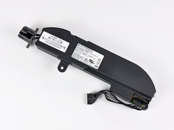

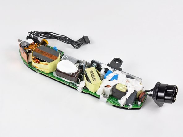

  22. Mac Mini Mid 2010 Teardown: crwdns2935265:022crwdnd2935265:01crwdnd2935265:03crwdne2935265:0 Mac Mini Mid 2010 Teardown: crwdns2935265:022crwdnd2935265:02crwdnd2935265:03crwdne2935265:0 Mac Mini Mid 2010 Teardown: crwdns2935265:022crwdnd2935265:03crwdnd2935265:03crwdne2935265:0
    • The new Mini's power supply churns out a minuscule 7 Amps at 12V. Compare that to the 25.8 Amps at 12V cranked out by the iMac Intel 27".
    • Like its iMac cousin, the Mac Mini finally says goodbye to external AC adapters.
    • Holy capacitors! Fingertips beware.
