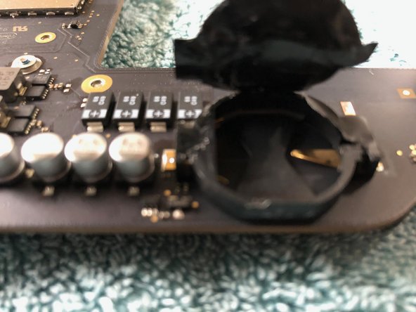

  13. Mac Mini Late 2014 NVRAM (PRAM) Battery Replacement, Peel tape: crwdns2935265:013crwdnd2935265:01crwdnd2935265:01crwdne2935265:0
    • Now the logic board is removed, turn the board over.
    • Peel the tape
  14. Mac Mini Late 2014 NVRAM (PRAM) Battery Replacement, Remove old battery: crwdns2935265:014crwdnd2935265:01crwdnd2935265:02crwdne2935265:0 Mac Mini Late 2014 NVRAM (PRAM) Battery Replacement, Remove old battery: crwdns2935265:014crwdnd2935265:02crwdnd2935265:02crwdne2935265:0
    • Use a spudger or small screwdriver to push the battery to the side and it will flip out
  15. Mac Mini Late 2014 NVRAM (PRAM) Battery Replacement, Put the tape back: crwdns2935265:015crwdnd2935265:01crwdnd2935265:01crwdne2935265:0
    • Insert the replacement battery
    • Put the tape back the best you can
While you can use the CR2032 the BR2032 is recommended as it has a higher heat tollerance and the type fitted by Apple. The chemical make up is also different. To reassemble your device, follow these instructions in reverse order.

Thanks! This guide helped a lot! To folks doing this replacement, the tape covering the battery comes up fairly easy if you first use your tweezers to gently lift the three tabs on the sides of the battery housing, then it should come off in one piece.
