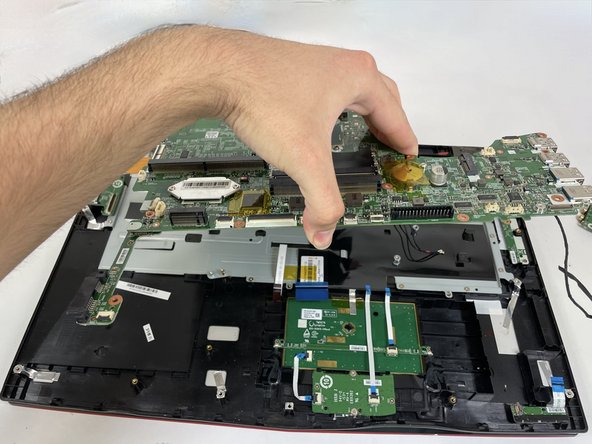

  19. MSI MS-1782 Motherboard Replacement, Motherboard: crwdns2935265:019crwdnd2935265:01crwdnd2935265:03crwdne2935265:0 MSI MS-1782 Motherboard Replacement, Motherboard: crwdns2935265:019crwdnd2935265:02crwdnd2935265:03crwdne2935265:0 MSI MS-1782 Motherboard Replacement, Motherboard: crwdns2935265:019crwdnd2935265:03crwdnd2935265:03crwdne2935265:0
    • Remove the five 5.6 mm screws holding the motherboard in place using a JIS #1 screwdriver.
    • Disconnect the display, keyboard, trackpad, and USB daughterboard ribbon connectors from the motherboard.
    • Before disconnecting the ribbon cables, lift the black tab before pulling the blue tabs on the cables.
    • Do not pull the cables out of the connector before lifting the black tab. Damage can occur to connector if not done so.
  20. MSI MS-1782 Motherboard Replacement: crwdns2935265:020crwdnd2935265:01crwdnd2935265:03crwdne2935265:0 MSI MS-1782 Motherboard Replacement: crwdns2935265:020crwdnd2935265:02crwdnd2935265:03crwdne2935265:0 MSI MS-1782 Motherboard Replacement: crwdns2935265:020crwdnd2935265:03crwdnd2935265:03crwdne2935265:0
    • Remove the two screws holding the sound daughterboard in place.
    • Disconnect the cable attached to the board.
    • The daughterboard is still connected to the laptop so just place it to the right.
  21. MSI MS-1782 Motherboard Replacement: crwdns2935265:021crwdnd2935265:01crwdnd2935265:03crwdne2935265:0 MSI MS-1782 Motherboard Replacement: crwdns2935265:021crwdnd2935265:02crwdnd2935265:03crwdne2935265:0 MSI MS-1782 Motherboard Replacement: crwdns2935265:021crwdnd2935265:03crwdnd2935265:03crwdne2935265:0
    • Lift the daughterboard and turn it to the back.
    • Lift the clear tape and pull the connector straight back to disconnect the daughterboard.
  22. MSI MS-1782 Motherboard Replacement: crwdns2935265:022crwdnd2935265:01crwdnd2935265:02crwdne2935265:0 MSI MS-1782 Motherboard Replacement: crwdns2935265:022crwdnd2935265:02crwdnd2935265:02crwdne2935265:0
    • Disconnect the USB daughterboard from the motherboard.
    • The orange ribbon cable is attached to the underside of the motherboard so it will stay attached when removing the motherboard.
  23. MSI MS-1782 Motherboard Replacement: crwdns2935265:023crwdnd2935265:01crwdnd2935265:02crwdne2935265:0 MSI MS-1782 Motherboard Replacement: crwdns2935265:023crwdnd2935265:02crwdnd2935265:02crwdne2935265:0
    • To remove the motherboard, lift it vertically out of the chassis.
