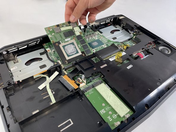

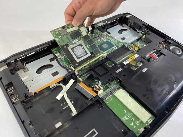

  9. MSI MS-1782 GPU Replacement, GPU: crwdns2935265:09crwdnd2935265:01crwdnd2935265:03crwdne2935265:0 MSI MS-1782 GPU Replacement, GPU: crwdns2935265:09crwdnd2935265:02crwdnd2935265:03crwdne2935265:0 MSI MS-1782 GPU Replacement, GPU: crwdns2935265:09crwdnd2935265:03crwdnd2935265:03crwdne2935265:0
    • Remove the two 5.0 mm screws holding the GPU by using a JIS #1 screwdriver.
  10. MSI MS-1782 GPU Replacement: crwdns2935265:010crwdnd2935265:01crwdnd2935265:03crwdne2935265:0 MSI MS-1782 GPU Replacement: crwdns2935265:010crwdnd2935265:02crwdnd2935265:03crwdne2935265:0 MSI MS-1782 GPU Replacement: crwdns2935265:010crwdnd2935265:03crwdnd2935265:03crwdne2935265:0
    • Gently lift the GPU and pull to remove it from the laptop.
