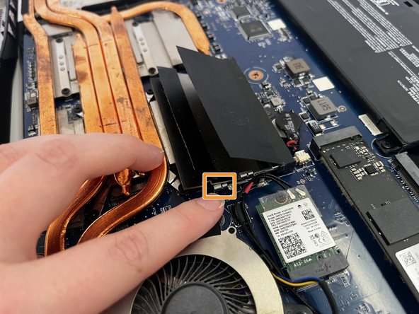

  4. MSI Katana 15 B13VEK RAM Replacement: crwdns2935265:04crwdnd2935265:01crwdnd2935265:03crwdne2935265:0 MSI Katana 15 B13VEK RAM Replacement: crwdns2935265:04crwdnd2935265:02crwdnd2935265:03crwdne2935265:0 MSI Katana 15 B13VEK RAM Replacement: crwdns2935265:04crwdnd2935265:03crwdnd2935265:03crwdne2935265:0
    • Locate the existing RAM memory slot flap and gently pull apart the clamps holding the RAM in place.
    • Once the clamps have been pulled apart, remove the existing faulty RAM and set aside from the exposed laptop.
