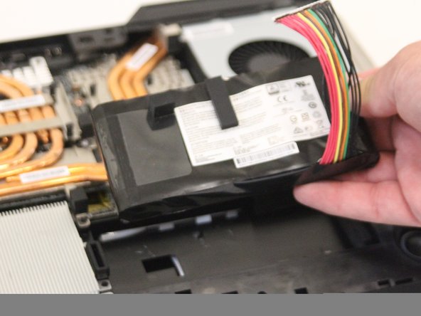

    • Carefully unplug the battery and remove it from the laptop. This will be held down with adhesive, but can be safely removed once unplugged.
