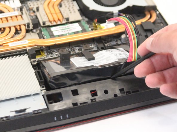

    • Using the Phillips #0 screwdriver, unscrew each of the four screws on the back of the laptop case. The screws are 0.5 inches long.
  2. MSI GT75VR 7RF Titan Pro Cooling Fan Replacement: crwdns2935265:02crwdnd2935265:01crwdnd2935265:02crwdne2935265:0 MSI GT75VR 7RF Titan Pro Cooling Fan Replacement: crwdns2935265:02crwdnd2935265:02crwdnd2935265:02crwdne2935265:0
    • Pop the back cover off of the laptop using the black nylon spudger.
  3. MSI GT75VR 7RF Titan Pro Cooling Fan Replacement: crwdns2935265:03crwdnd2935265:01crwdnd2935265:02crwdne2935265:0 MSI GT75VR 7RF Titan Pro Cooling Fan Replacement: crwdns2935265:03crwdnd2935265:02crwdnd2935265:02crwdne2935265:0
    • Disconnect the battery cable. Pry the battery out using the black nylon spudger.
  4. MSI GT75VR 7RF Titan Pro Cooling Fan Replacement: crwdns2935265:04crwdnd2935265:01crwdnd2935265:02crwdne2935265:0 MSI GT75VR 7RF Titan Pro Cooling Fan Replacement: crwdns2935265:04crwdnd2935265:02crwdnd2935265:02crwdne2935265:0
    • Using the Phillips #0 screwdriver, unscrew the two black 0.25 inch screws located on the sides of the cooling fan.
    • Unplug the unit.
