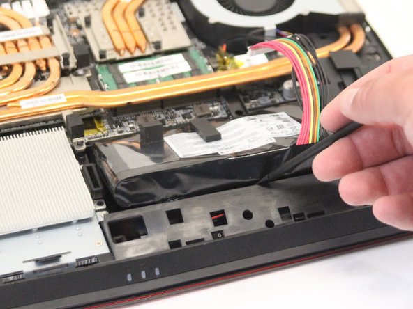

    • Pop off the back cover of the laptop using the black nylon spudger.
  3. MSI GT75VR 7RF Titan Pro Battery Replacement: crwdns2935265:03crwdnd2935265:01crwdnd2935265:03crwdne2935265:0 MSI GT75VR 7RF Titan Pro Battery Replacement: crwdns2935265:03crwdnd2935265:02crwdnd2935265:03crwdne2935265:0 MSI GT75VR 7RF Titan Pro Battery Replacement: crwdns2935265:03crwdnd2935265:03crwdnd2935265:03crwdne2935265:0

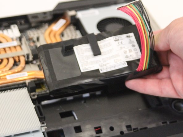

    • Unplug the battery, then using the black nylon spudger, carefully remove it from the laptop. It is held down by an adhesive, but can be safely removed without damaging the device.
