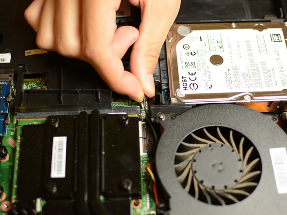

    • Remove the seven 6 mm Phillips #00 screws on the back cover of the laptop with the PH0 Bit screwdriver.
    • Every screw in this guide can be removed with the same PH0 Bit screwdriver.
  2. MSI GT72 2QE Dominator Pro Fans Replacement: crwdns2935265:02crwdnd2935265:01crwdnd2935265:01crwdne2935265:0
    • Lift the back cover off by lifting by the tab on the bottom of the cover as indicated.
  3. MSI GT72 2QE Dominator Pro Fans Replacement: crwdns2935265:03crwdnd2935265:01crwdnd2935265:02crwdne2935265:0 MSI GT72 2QE Dominator Pro Fans Replacement: crwdns2935265:03crwdnd2935265:02crwdnd2935265:02crwdne2935265:0
    • Detach the two indicated wires by pulling upward on them.
  4. MSI GT72 2QE Dominator Pro Fans Replacement: crwdns2935265:04crwdnd2935265:01crwdnd2935265:01crwdne2935265:0
    • Unscrew a total of four 10mm Philips #00 screws (two screws per fan) as indicated.
