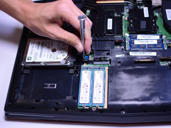

  3. MSI GT72 2QE Dominator Pro CD Drive Replacement: crwdns2935265:03crwdnd2935265:01crwdnd2935265:03crwdne2935265:0 MSI GT72 2QE Dominator Pro CD Drive Replacement: crwdns2935265:03crwdnd2935265:02crwdnd2935265:03crwdne2935265:0 MSI GT72 2QE Dominator Pro CD Drive Replacement: crwdns2935265:03crwdnd2935265:03crwdnd2935265:03crwdne2935265:0
    • Remove the indicated 5mm Phillips #0 screw.
    • This is the only screw holding the CD drive in place. Do not lose it.
  4. MSI GT72 2QE Dominator Pro CD Drive Replacement: crwdns2935265:04crwdnd2935265:01crwdnd2935265:01crwdne2935265:0
    • Using the plastic opening tool, pull out the CD drive.

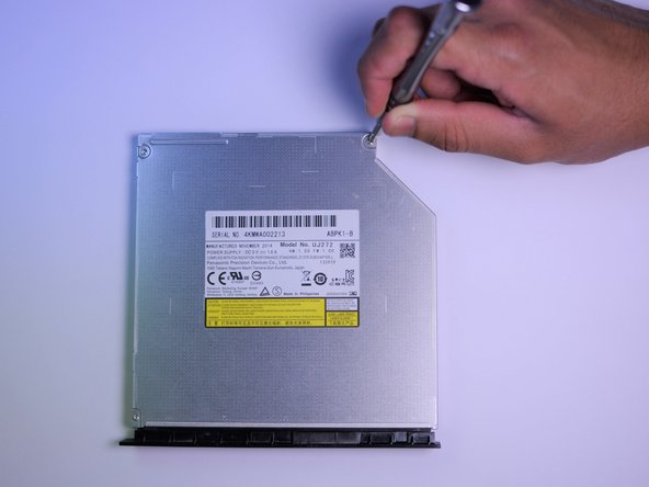

  5. MSI GT72 2QE Dominator Pro CD Drive Replacement: crwdns2935265:05crwdnd2935265:01crwdnd2935265:02crwdne2935265:0 MSI GT72 2QE Dominator Pro CD Drive Replacement: crwdns2935265:05crwdnd2935265:02crwdnd2935265:02crwdne2935265:0
    • Remove the indicated 4mm Phillips #0 screw and metal hinge.
  6. MSI GT72 2QE Dominator Pro CD Drive Replacement: crwdns2935265:06crwdnd2935265:01crwdnd2935265:02crwdne2935265:0 MSI GT72 2QE Dominator Pro CD Drive Replacement: crwdns2935265:06crwdnd2935265:02crwdnd2935265:02crwdne2935265:0
    • Remove the three (3) indicated 2mm Phillips #0 screws.
  7. MSI GT72 2QE Dominator Pro CD Drive Replacement: crwdns2935265:07crwdnd2935265:01crwdnd2935265:02crwdne2935265:0 MSI GT72 2QE Dominator Pro CD Drive Replacement: crwdns2935265:07crwdnd2935265:02crwdnd2935265:02crwdne2935265:0
    • Lift metal cover gently, using the tab like indent located where the arrow is pointed.
    • This should expose the inside of the CD drive.
