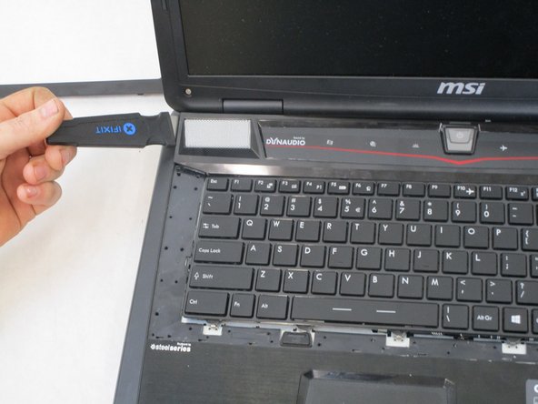

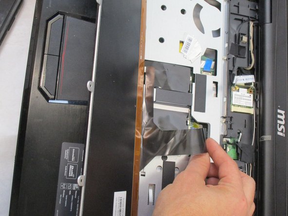

  7. MSI GT70 MS-1763 Keyboard Replacement, Keyboard: crwdns2935265:07crwdnd2935265:01crwdnd2935265:03crwdne2935265:0 MSI GT70 MS-1763 Keyboard Replacement, Keyboard: crwdns2935265:07crwdnd2935265:02crwdnd2935265:03crwdne2935265:0 MSI GT70 MS-1763 Keyboard Replacement, Keyboard: crwdns2935265:07crwdnd2935265:03crwdnd2935265:03crwdne2935265:0
    • Using a Jimmy, remove the outer cover around the keyboard.
    • Remove the ribbon cable from the ZIF connector on the underside of the top cover.

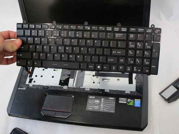

  8. MSI GT70 MS-1763 Keyboard Replacement: crwdns2935265:08crwdnd2935265:01crwdnd2935265:02crwdne2935265:0 MSI GT70 MS-1763 Keyboard Replacement: crwdns2935265:08crwdnd2935265:02crwdnd2935265:02crwdne2935265:0
    • Using a Phillips #0 screwdriver, remove the five 3 mm screws at the top of the keyboard.
  9. MSI GT70 MS-1763 Keyboard Replacement: crwdns2935265:09crwdnd2935265:01crwdnd2935265:01crwdne2935265:0
    • Flip the keyboard back and disconnect the keyboard cable.

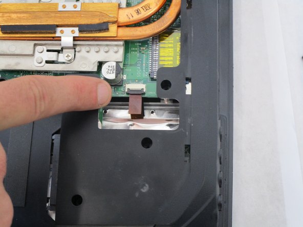

  10. MSI GT70 MS-1763 Keyboard Replacement: crwdns2935265:010crwdnd2935265:01crwdnd2935265:03crwdne2935265:0 MSI GT70 MS-1763 Keyboard Replacement: crwdns2935265:010crwdnd2935265:02crwdnd2935265:03crwdne2935265:0 MSI GT70 MS-1763 Keyboard Replacement: crwdns2935265:010crwdnd2935265:03crwdnd2935265:03crwdne2935265:0
    • Flip the laptop over and disconnect the data cable from the ZIF connector on the bottom right.
    • You can now turn the laptop back over and remove the keyboard.

Mine is the Cyberbuypower rebadge of this model. And you only need to remove the two keyboards screws on the bottom. And then the top button board (called outer cover here)
Even here I don’t see why you have to remove all those screws.
