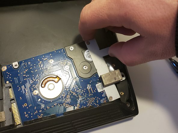

    • Remove the two screws securing the hard drive to the laptop.
    • Lightly lift the hard drive up by grasping the silver bracket that secures it to the laptop.
    • Wiggle it backwards slowly until it is unplugged.
    • Slide out from under the cover towards the battery.

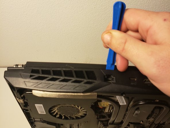

  7. MSI GT62VR 6RD Dominator Speaker Replacement, Speaker: crwdns2935265:07crwdnd2935265:01crwdnd2935265:02crwdne2935265:0 MSI GT62VR 6RD Dominator Speaker Replacement, Speaker: crwdns2935265:07crwdnd2935265:02crwdnd2935265:02crwdne2935265:0
    • Insert the plastic opening tool into the side of the laptop above the fan, and lightly pry it up.
    • The laptop will break if it is being handle roughly.
    • Slide the plastic opening tool around the laptop's edge gently, while slowly popping off the clips securing it into the laptop.

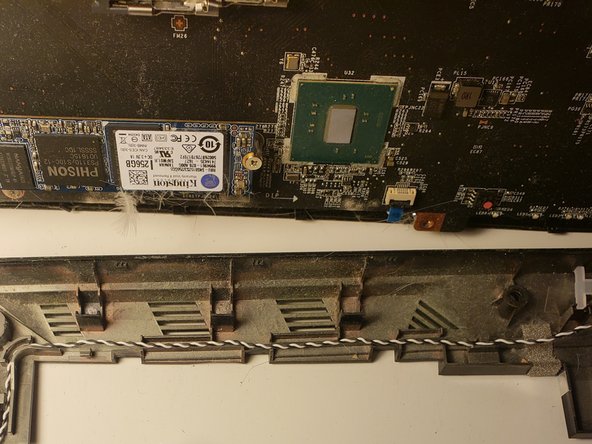

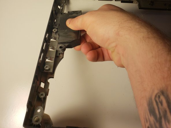

  8. MSI GT62VR 6RD Dominator Speaker Replacement: crwdns2935265:08crwdnd2935265:01crwdnd2935265:02crwdne2935265:0 MSI GT62VR 6RD Dominator Speaker Replacement: crwdns2935265:08crwdnd2935265:02crwdnd2935265:02crwdne2935265:0
    • Slowly pop off the clips securing the speaker to the laptop side frame.

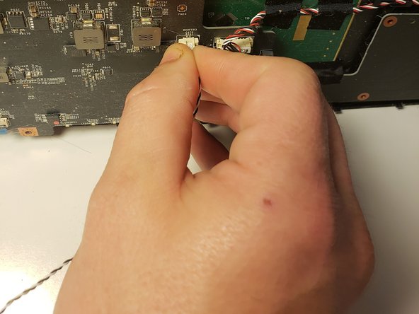

  9. MSI GT62VR 6RD Dominator Speaker Replacement: crwdns2935265:09crwdnd2935265:01crwdnd2935265:03crwdne2935265:0 MSI GT62VR 6RD Dominator Speaker Replacement: crwdns2935265:09crwdnd2935265:02crwdnd2935265:03crwdne2935265:0 MSI GT62VR 6RD Dominator Speaker Replacement: crwdns2935265:09crwdnd2935265:03crwdnd2935265:03crwdne2935265:0
    • Locate the speaker wires.
    • The speaker wires are attached to the speaker. By running your hand across the speaker wires, you can find its location on the motherboard.
    • Place your hands at the corners of the wires.
    • Pull upward from the motherboard where the wires are located.
