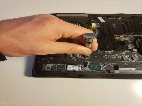

    • Remove the six 1.2mm screws on the bottom plate of the laptop using a JIS #0 screwdriver.
  2. MSI GT62VR 6RD Dominator M.2 SSD Replacement: crwdns2935265:02crwdnd2935265:01crwdnd2935265:03crwdne2935265:0 MSI GT62VR 6RD Dominator M.2 SSD Replacement: crwdns2935265:02crwdnd2935265:02crwdnd2935265:03crwdne2935265:0 MSI GT62VR 6RD Dominator M.2 SSD Replacement: crwdns2935265:02crwdnd2935265:03crwdnd2935265:03crwdne2935265:0
    • Insert the plastic opening tool into the seam on the backplate of the laptop.
    • A popping sound will be produced from your device while you remove the backplate.
    • Pry the back plate up.
    • Slide the plastic opening tool around the laptop's edge slowly until the backplate is completely removed.
  3. MSI GT62VR 6RD Dominator M.2 SSD Replacement: crwdns2935265:03crwdnd2935265:01crwdnd2935265:02crwdne2935265:0 MSI GT62VR 6RD Dominator M.2 SSD Replacement: crwdns2935265:03crwdnd2935265:02crwdnd2935265:02crwdne2935265:0
    • Remove the single 1.2mm screw securing the SSD to the laptop using the JIS #0 screwdriver.
  4. MSI GT62VR 6RD Dominator M.2 SSD Replacement: crwdns2935265:04crwdnd2935265:01crwdnd2935265:02crwdne2935265:0 MSI GT62VR 6RD Dominator M.2 SSD Replacement: crwdns2935265:04crwdnd2935265:02crwdnd2935265:02crwdne2935265:0
    • Remove the old SSD, then insert and screw in the new one.

Isn’t that an M.2 Drive not a GPU? the GPU is in the top right. under the heat pipes.
