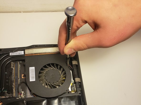

    • Remove the three 2.0mm screws using the JIS #0 screwdriver.

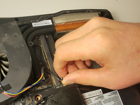

    • The white plastic clip secures the fan wires to the laptop.
    • Unplug the white clip by grasping it and wiggling it back and forth .
    • Do not pull the clip out by the wires themselves.
