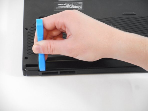

  5. MSI GS66 Stealth 11UE-007 RAM Replacement: crwdns2935265:05crwdnd2935265:01crwdnd2935265:03crwdne2935265:0 MSI GS66 Stealth 11UE-007 RAM Replacement: crwdns2935265:05crwdnd2935265:02crwdnd2935265:03crwdne2935265:0 MSI GS66 Stealth 11UE-007 RAM Replacement: crwdns2935265:05crwdnd2935265:03crwdnd2935265:03crwdne2935265:0
    • Use the tip of the blue plastic opening tool to slip between the backplate and the body of the laptop at the hinge side.
    • Wiggle the blue plastic opening tool as you slide it around the perimeter of the backplate to separate is from the body of the laptop.

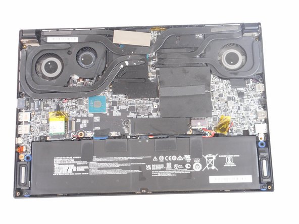

  6. MSI GS66 Stealth 11UE-007 RAM Replacement: crwdns2935265:06crwdnd2935265:01crwdnd2935265:02crwdne2935265:0 MSI GS66 Stealth 11UE-007 RAM Replacement: crwdns2935265:06crwdnd2935265:02crwdnd2935265:02crwdne2935265:0
    • Lift back black plastic.

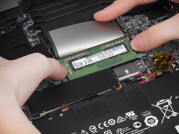

  7. MSI GS66 Stealth 11UE-007 RAM Replacement: crwdns2935265:07crwdnd2935265:01crwdnd2935265:02crwdne2935265:0 MSI GS66 Stealth 11UE-007 RAM Replacement: crwdns2935265:07crwdnd2935265:02crwdnd2935265:02crwdne2935265:0
    • Place both thumbs on metal tabs and apply pressure in a widening motion until RAM lifts.
  8. MSI GS66 Stealth 11UE-007 RAM Replacement: crwdns2935265:08crwdnd2935265:01crwdnd2935265:01crwdne2935265:0
    • Pull RAM straight out from the connector at the angle it lifted at.
