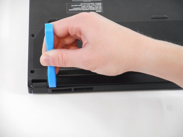

  5. MSI GS66 Stealth 11UE-007 NVMe SSD Replacement: crwdns2935265:05crwdnd2935265:01crwdnd2935265:03crwdne2935265:0 MSI GS66 Stealth 11UE-007 NVMe SSD Replacement: crwdns2935265:05crwdnd2935265:02crwdnd2935265:03crwdne2935265:0 MSI GS66 Stealth 11UE-007 NVMe SSD Replacement: crwdns2935265:05crwdnd2935265:03crwdnd2935265:03crwdne2935265:0
    • Use the tip of the blue plastic opening tool to slip between the backplate and the body of the laptop at the hinge side.
    • Wiggle the blue plastic opening tool as you slide it around the perimeter of the backplate to separate it from the body of the laptop.

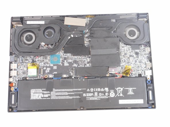

  6. MSI GS66 Stealth 11UE-007 NVMe SSD Replacement: crwdns2935265:06crwdnd2935265:01crwdnd2935265:01crwdne2935265:0
    • Lift back black plastic.
  7. MSI GS66 Stealth 11UE-007 NVMe SSD Replacement: crwdns2935265:07crwdnd2935265:01crwdnd2935265:01crwdne2935265:0
    • Remove one 4 mm Phillips #1 screw.

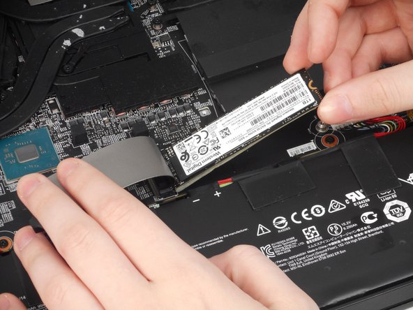

  8. MSI GS66 Stealth 11UE-007 NVMe SSD Replacement: crwdns2935265:08crwdnd2935265:01crwdnd2935265:02crwdne2935265:0 MSI GS66 Stealth 11UE-007 NVMe SSD Replacement: crwdns2935265:08crwdnd2935265:02crwdnd2935265:02crwdne2935265:0
    • Lift the drive up to forty-five degrees and pull at that forty-five degree angle away from the connector.

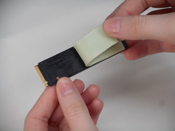

  9. MSI GS66 Stealth 11UE-007 NVMe SSD Replacement: crwdns2935265:09crwdnd2935265:01crwdnd2935265:02crwdne2935265:0 MSI GS66 Stealth 11UE-007 NVMe SSD Replacement: crwdns2935265:09crwdnd2935265:02crwdnd2935265:02crwdne2935265:0
    • Remove the thermal pad.
