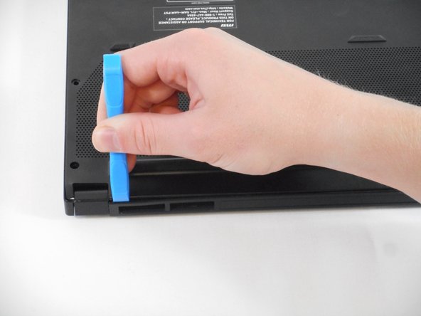

    • Use the tip of the blue plastic opening tool to slip between the backplate and the body of the laptop at the hinge side.
    • Wiggle the blue plastic opening tool as you slide it around the perimeter of the backplate to separate is from the body of the laptop.

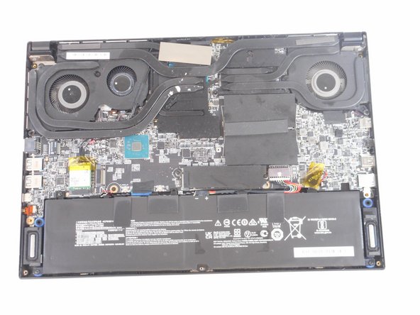

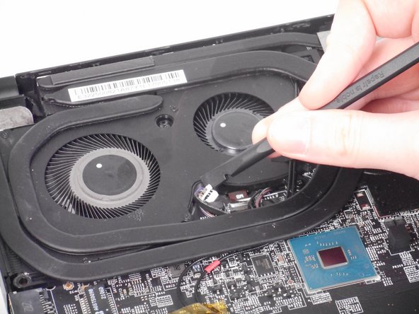

  4. MSI GS66 Stealth 11UE-007 Cooling Fan Replacement: crwdns2935265:04crwdnd2935265:01crwdnd2935265:02crwdne2935265:0 MSI GS66 Stealth 11UE-007 Cooling Fan Replacement: crwdns2935265:04crwdnd2935265:02crwdnd2935265:02crwdne2935265:0
    • Disconnect the wires from the cooling fan.
  5. MSI GS66 Stealth 11UE-007 Cooling Fan Replacement: crwdns2935265:05crwdnd2935265:01crwdnd2935265:02crwdne2935265:0 MSI GS66 Stealth 11UE-007 Cooling Fan Replacement: crwdns2935265:05crwdnd2935265:02crwdnd2935265:02crwdne2935265:0

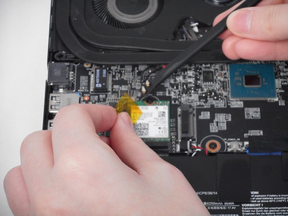

    • Disconnect the two wires from the Wi-Fi card.

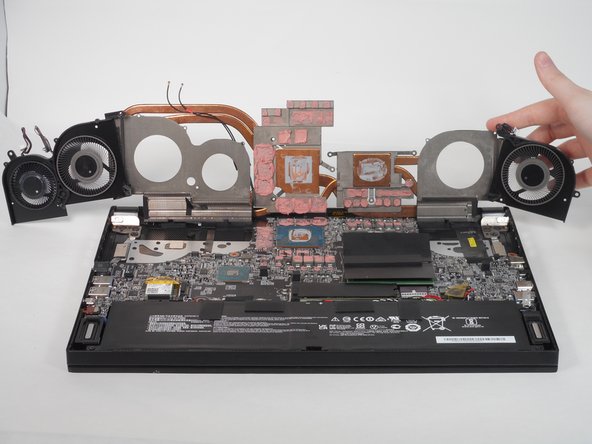

  8. MSI GS66 Stealth 11UE-007 Cooling Fan Replacement: crwdns2935265:08crwdnd2935265:01crwdnd2935265:01crwdne2935265:0
    • Lift up the cooling unit like it is hinged at the back.
    • Replace thermal paste.

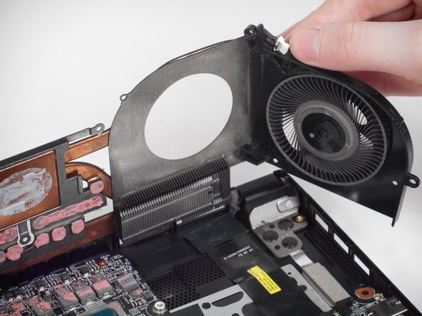

  9. MSI GS66 Stealth 11UE-007 Cooling Fan Replacement, Cooling Fan: crwdns2935265:09crwdnd2935265:01crwdnd2935265:03crwdne2935265:0 MSI GS66 Stealth 11UE-007 Cooling Fan Replacement, Cooling Fan: crwdns2935265:09crwdnd2935265:02crwdnd2935265:03crwdne2935265:0 MSI GS66 Stealth 11UE-007 Cooling Fan Replacement, Cooling Fan: crwdns2935265:09crwdnd2935265:03crwdnd2935265:03crwdne2935265:0
    • Remove the fans
    • Orient your laptop so that the bottom is facing up and the hinge is away from yourself.

Rachel Kelley - crwdns2934203:0crwdne2934203:0
Please correct order of pictures. Description is correct but you put wrong pictures in spots. WiFi adapter isn't tape holding the heatsink assembly down.
