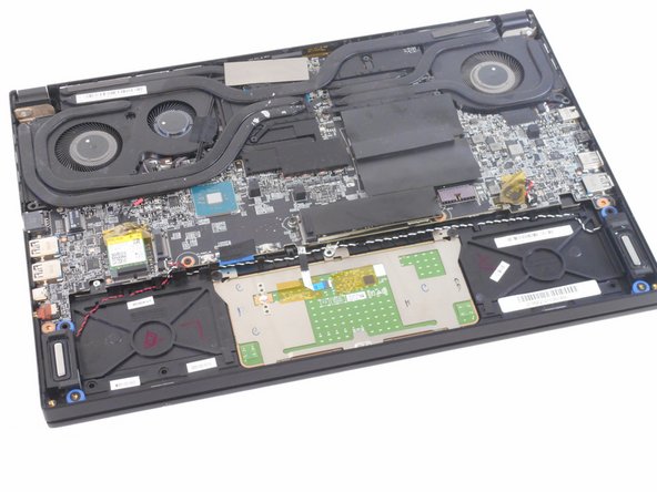

    • Orient your laptop so that the bottom is facing up and the hinge is away from yourself.
    • Make sure to unplug device.
  2. MSI GS66 Stealth 11UE-007 Battery Replacement: crwdns2935265:02crwdnd2935265:01crwdnd2935265:01crwdne2935265:0
    • Identify the nine screws around the perimeter. One screw will be under the factory seal sticker.
  3. MSI GS66 Stealth 11UE-007 Battery Replacement: crwdns2935265:03crwdnd2935265:01crwdnd2935265:01crwdne2935265:0
    • Remove eight 10 mm Phillips #1 screws.
  4. MSI GS66 Stealth 11UE-007 Battery Replacement: crwdns2935265:04crwdnd2935265:01crwdnd2935265:01crwdne2935265:0
    • Remove one 7 mm Phillips #1 screw from the center bottom of backplate.
  5. MSI GS66 Stealth 11UE-007 Battery Replacement: crwdns2935265:05crwdnd2935265:01crwdnd2935265:03crwdne2935265:0 MSI GS66 Stealth 11UE-007 Battery Replacement: crwdns2935265:05crwdnd2935265:02crwdnd2935265:03crwdne2935265:0 MSI GS66 Stealth 11UE-007 Battery Replacement: crwdns2935265:05crwdnd2935265:03crwdnd2935265:03crwdne2935265:0
    • Use the tip of the blue plastic opening tool to slip between the backplate and the body of the laptop at the hinge side.
    • Wiggle the blue plastic opening tool as you slide it around the perimeter of the backplate to separate is from the body of the laptop.
  6. MSI GS66 Stealth 11UE-007 Battery Replacement: crwdns2935265:06crwdnd2935265:01crwdnd2935265:01crwdne2935265:0
    • Peal back metallic tape on the right side of the USB port.
  7. MSI GS66 Stealth 11UE-007 Battery Replacement: crwdns2935265:07crwdnd2935265:01crwdnd2935265:02crwdne2935265:0 MSI GS66 Stealth 11UE-007 Battery Replacement: crwdns2935265:07crwdnd2935265:02crwdnd2935265:02crwdne2935265:0
    • Remove three 6 mm Phillips #1 screws.
  8. MSI GS66 Stealth 11UE-007 Battery Replacement: crwdns2935265:08crwdnd2935265:01crwdnd2935265:01crwdne2935265:0
    • Use the tip of the spudger or your fingernail to gently push out the white connector.
  9. MSI GS66 Stealth 11UE-007 Battery Replacement: crwdns2935265:09crwdnd2935265:01crwdnd2935265:02crwdne2935265:0 MSI GS66 Stealth 11UE-007 Battery Replacement: crwdns2935265:09crwdnd2935265:02crwdnd2935265:02crwdne2935265:0
    • Remove the battery from the device.
