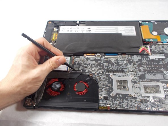

    • Locate the battery.
    • Wedge the spudger underneath the battery, and apply pressure to lift it away from the rest of the device.
    • Gently pull and wiggle the multiple colored wired connector out from the socket.
    • If you are removing the original battery, the back has a couple foam strips that were installed for cushioning. Those can be carefully removed and placed on the new replacement battery, but it is not necessary.

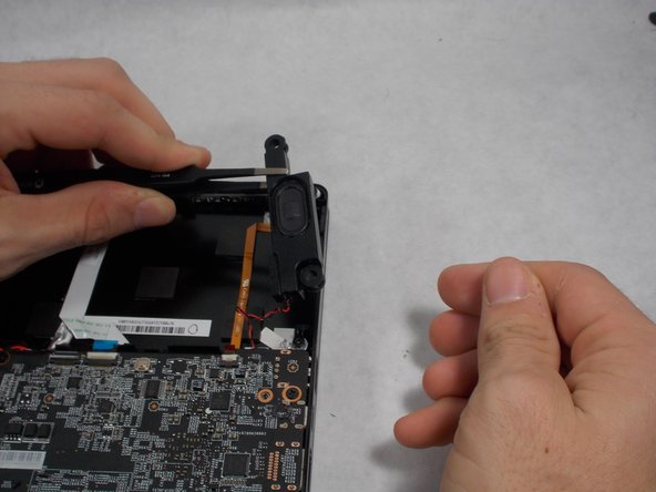

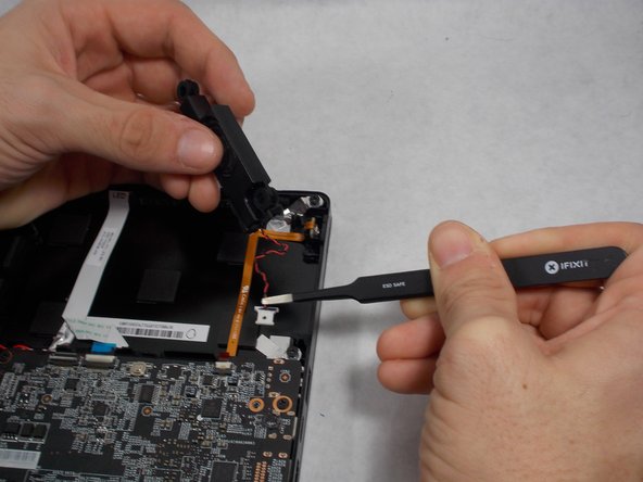

  6. MSI GS63VR 7RF Stealth Pro SSD Replacement, Speakers: crwdns2935265:06crwdnd2935265:01crwdnd2935265:03crwdne2935265:0 MSI GS63VR 7RF Stealth Pro SSD Replacement, Speakers: crwdns2935265:06crwdnd2935265:02crwdnd2935265:03crwdne2935265:0 MSI GS63VR 7RF Stealth Pro SSD Replacement, Speakers: crwdns2935265:06crwdnd2935265:03crwdnd2935265:03crwdne2935265:0
    • First locate the speaker(s).
    • Use the tweezers to lift the speaker from its position.
    • Grab the multi-colored wire with the tweezers and gently pull back until the speakers releases from its socket.
    • Applies for both speakers.
    • Keep track of which speaker went where. The connectors for the speakers are unique; you cannot use a speaker that should go on the right side on the left side and vice versa.
