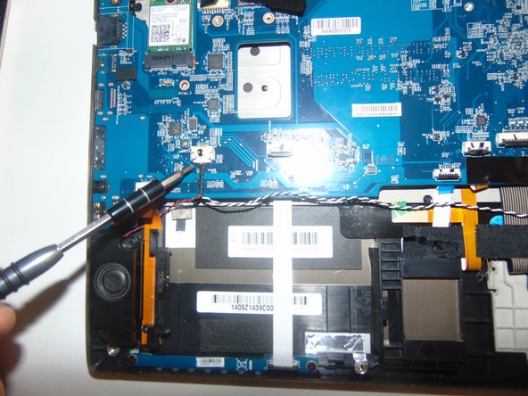

  7. MSI GS60 Ghost Pro 4K Gold Edition Speaker Replacement, Speaker: crwdns2935265:07crwdnd2935265:01crwdnd2935265:02crwdne2935265:0 MSI GS60 Ghost Pro 4K Gold Edition Speaker Replacement, Speaker: crwdns2935265:07crwdnd2935265:02crwdnd2935265:02crwdne2935265:0
    • Disconnect the wires connnecting the speaker to the motherboard by grasping the portion of the cable covered in black shielding, and carefully pulling it horizontally away from the port it is connected to.
    • Be careful not to pull the cable too hard and bend the port on connecting the speakers to the motherboard.

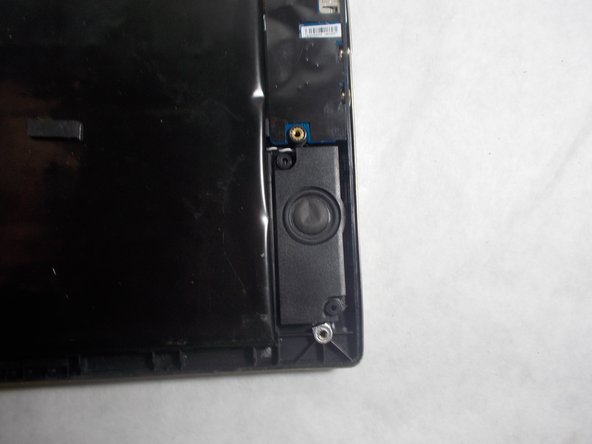

  8. MSI GS60 Ghost Pro 4K Gold Edition Speaker Replacement: crwdns2935265:08crwdnd2935265:01crwdnd2935265:02crwdne2935265:0 MSI GS60 Ghost Pro 4K Gold Edition Speaker Replacement: crwdns2935265:08crwdnd2935265:02crwdnd2935265:02crwdne2935265:0
    • Use the screwdriver to unscrew the 4 1.5mm Phillips #0 screws connecting the speakers to the frame of the device.
    • There are 2 individual speaker modules, with 2 screws each.

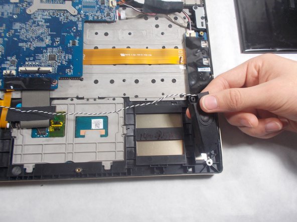

  9. MSI GS60 Ghost Pro 4K Gold Edition Speaker Replacement: crwdns2935265:09crwdnd2935265:01crwdnd2935265:02crwdne2935265:0 MSI GS60 Ghost Pro 4K Gold Edition Speaker Replacement: crwdns2935265:09crwdnd2935265:02crwdnd2935265:02crwdne2935265:0
    • Carefully pull both the left and right speaker modules out of the computer.
