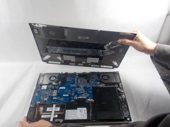

    • Place this device back panel facing up.
  2. MSI GS60 Ghost Pro 4K Gold Edition Back Panel Replacement: crwdns2935265:02crwdnd2935265:01crwdnd2935265:01crwdne2935265:0
    • Using the screwdriver, unscrew the highlighted 1.2mm Phillips head #0 screws which secure the back panel into place.
  3. MSI GS60 Ghost Pro 4K Gold Edition Back Panel Replacement: crwdns2935265:03crwdnd2935265:01crwdnd2935265:02crwdne2935265:0 MSI GS60 Ghost Pro 4K Gold Edition Back Panel Replacement: crwdns2935265:03crwdnd2935265:02crwdnd2935265:02crwdne2935265:0
    • Using the plastic opening tools, separate the back panel from the rest of the device.
    • Do this by firmly pressing the head of the tool into the space between the back panel, and the rest of the device.
