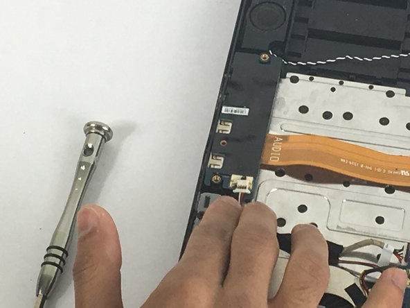

  5. MSI GS60 6QE GHOST PRO 4K Motherboard Replacement: crwdns2935265:05crwdnd2935265:01crwdnd2935265:01crwdne2935265:0
    • Unplug the speaker wire.
